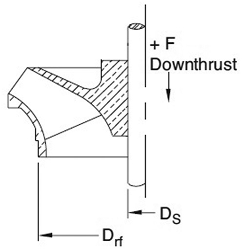

Q. How does axial thrust compare among different impeller types for a rotodynamic vertical pump?
A.  The net axial downthrust force is carried by the pump shaft. The shaft will stretch, or elongate, under this load. Before the pump starts up, any stretch that occurs is due to rotor weight, the sum of the static forces. The thrust load will increase after the pump starts up due to the addition of the dynamic forces.
The dynamic forces creating thrust on a vertical turbine pump enclosed impeller (see Figure 2.3.3.2.3a) are due to the difference in pressure distributions on the upper and lower shrouds along with the force from the change in momentum of the flow through the impeller.

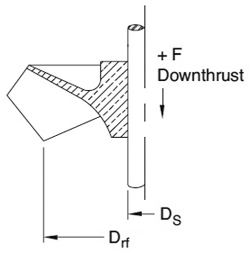

The semi-open impeller (see Figure 2.3.3.2.3b) has only an upper shroud. The difference in pressure distributions along the backside and vaned side of the shroud is typically greater than between upper and lower shrouds of an enclosed impeller. Semi-open impeller axial thrust is higher than that of the enclosed impeller.

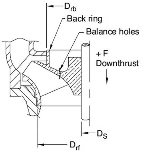

The impeller back ring with balance holes configuration (see Figure 2.3.3.2.3c) reduces axial thrust. Back rings may be cast integrally into impellers with a top shroud. They are used when pump total axial thrust requires reduction. The flow through balance holes in the impeller hub shroud, combined with the leakage past the balance ring, reduces efficiency. The exact efficiency reduction depends on the individual design, pump size and specific speed. The effect of increased leakage through the clearances because of wear of the back ring arrangement may be an increase in downthrust and should be considered in sizing the thrust bearing.
For more information about axial thrust for vertical rotodynamic pumps, see ANSI/HI 2.3 Rotodynamic (Vertical) Pumps for Design and Application.
Figure 2.3.3.2.3a. Enclosed impeller plain top shroud
Figure 2.3.3.2.3b. Semi-open impeller
Figure 2.3.3.2.3c. Enclosed impeller with back ring and balance holes
