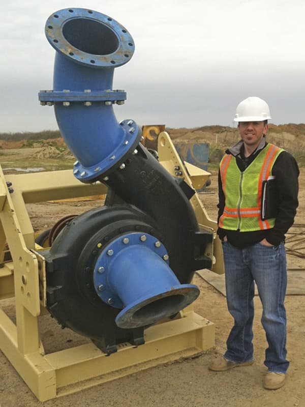

A distributor for a pump provider visited the site to better understand the hydrology of the situation and offer different solutions. Replacing the cantilevered sump pumps was explored, as well as the possibility of mounting pumps on the edge of the pit. Mounting pumps on the edge seemed impractical because of net positive suction head available (NPSHa) concerns. The pump would require frequent restaging to the proper elevation because of the changes in the pit’s water level. The vertical cantilevered slurry pumps that were examined required a much deeper minimum submergence than was available because of the water’s varying levels. The pumps were also not very efficient and had a relatively high net positive suction head required (NPSHr). Maintenance and parts availability were also issues.
Workers at the aggregate company prepare the newly outfitted barges with the dewatering pumps.- The pumps could operate without drawing in as much debris and particulates, which clogged the vertical pumps. If the pumps pulled in debris, they had a solids-handling capability of 4.75 inches.
- NPSHr was minimized, reducing the chance for vortexing and allowing the pumps to operate in relatively shallow conditions.
- The pumps were able to maintain their efficiencies—operating at an impressive 82.5 percent.
- The system did not require mechanical priming.
Conclusion
The pumps have been installed since March 2012 and have functioned well. The company reports that they are efficient and quiet. Most important, electricity is one of highest cost components in creating concrete from the mined aggregate. Through the dewatering pump’s superior efficiencies, the mining company has saved more than $30,000 in energy and maintenance costs per year. The company’s plant manager said that the pumps will improve efficiency while providing a quick payback on the upgrade costs. The direct-drive configuration will reduce maintenance, which is difficult because of the floating configuration. The operators have been impressed with the pumps’ performance. The speed with which they are able to lower the water level when needed has exceeded their expectations.Vortexing
