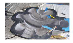

The pump's internal condition before sandblasting
Figure 1. The pump's internal condition before sandblasting
Figure 1 shows a typical pump's internal condition prior to sandblasting. This particular pump is a 600 horsepower model that was installed in the mid 1980's. As shown, the interior exhibits both surface corrosion and tuberculation. Figure 2 shows a better view of the tuberculation. In certain areas of the casing and cover, tubers were larger than one-half inch.
Figure 2 shows the interior of the pump after sandblasting. After sandblasting, the surface was evaluated to determine if application of the metal filler was required prior to coating. This particular pump exhibited a significant amount of surface pitting, and those pits were filled prior to the coating process. Figure 3 shows the same pump after application of the metal filler and two coats of ceramic filled, epoxy coating.
