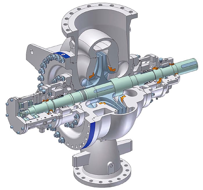

Q. What is a boiler feed booster pump, and why are they required in some power plants? A. Large fossil fuel power plants use high pressure and temperature boiler feed systems, which generally require large or high speed boiler feed pumps with controlled-compression gasketed joints. This is accomplished by selecting pumps of either barrel (BB5) (see Figure 3.8) or ring-section (BB4) design.
Figure 3.8. Boiler feed pump – BB5 Type. (Graphics courtesy of HI)
Figure 3.9 Boiler feed booster pump – BB2 Type
