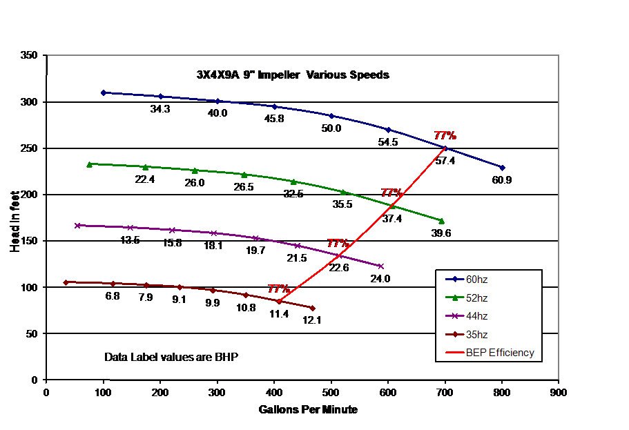

An alternative to trimming the impeller is to alter the impeller’s speed. This can be achieved in many ways. Figure 2 shows the same pump with four different speed curves that were selected to match the trims shown in Figure 1. These speed changes were produced by a variable frequency drive (VFD), so the curves are labeled in Hertz. Other speed change options include belt drives and adjustable, magnetic couplings.
The result is that BEP efficiency remains at the full-speed (diameter) efficiency (77 percent) across a broad range of speeds. This occurs because the impeller periphery to tongue clearance remains unchanged and recirculation is limited to its design conditions. The affinity laws also hold true across this range.

Figure 2. The same pump from Figure 1 with four speed curves
