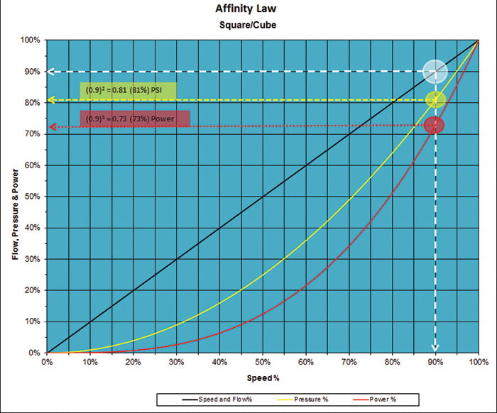

affinity curve graph 10 percentFigure 3. Affinity curves shown at 10 percent speed reduction
When observing the comparisons at a 10 percent reduction (Figure 3) in speed we see that power has dropped to 73 percent (or has been reduced by 27 percent). Also note that the pressure has dropped to 81 percent, or reduced by 19 percent of capacity. A 10 percent reduction in speed from a full speed of 60 Hertz (Hz) would be a drop of six Hz or operating the pump motor at 54 Hz. The ability to operate at this level indicates some excess capacity in the system, and hopefully the system was sized with slightly more capacity than this to allow for variations such as falling static water levels, which will yield more energy savings. Excess capacity will cost more but, if done at installation, is less expensive than pulling and replacing components or drilling a new well. The VFD provides other benefits to the system to justify installation on most water pumping applications:
