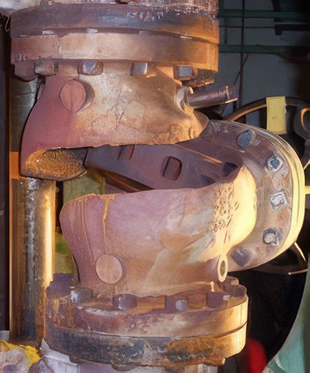

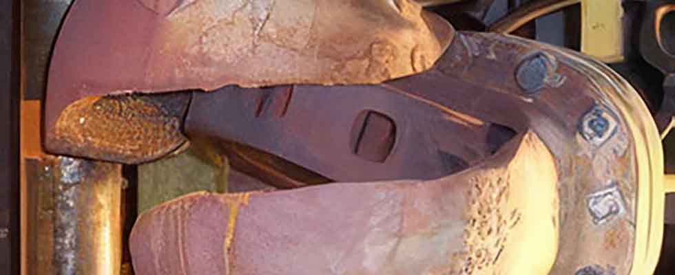

From a reliability standpoint, steam that is not dry enough will create erosion in the system and have a negative impact on heat transfer. Measuring steam dryness can be achieved with an instrument or by manually calculating the energy contained in the steam via a bucket and stopwatch test.
Ultimately, steam dryness should remain above 97% (containing less than 3% water droplets in suspension). If the steam quality is very poor (<95%), it could even lead to water hammer, which can be destructive and cause a safety hazard.

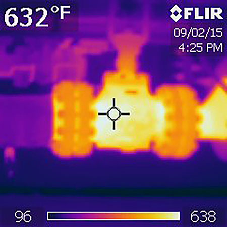

A steam distribution network in a chemical facility is usually extensive, creating many points where energy can be lost. To address these losses, a thermal imaging camera can be used to assess the insulation on steam lines, as well as uninsulated valves and
pipe accessories. The system should be properly drained of condensate to prevent water hammer and related safety risks.

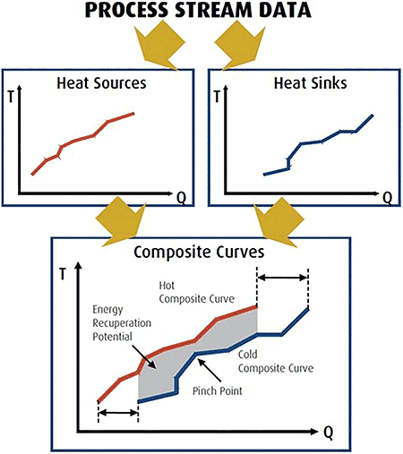

This methodology is enabled by pinch analysis, which calculates the minimum possible energy use for a process and identifies opportunities for heat recovery. It maps all heat sources and all heat sinks, then determines where energy can be exchanged directly through heat exchangers or upgraded with high-temperature heat pumps. The pinch point is the temperature at which the hot and cold composite curves come closest together. Above it, heating utilities are used, and below it, cooling utilities. The area around the pinch represents heat recovery potential without additional energy input. To maximize recovery, heat exchangers should not cross the pinch point. Low-grade heat that cannot be recovered directly can be upgraded with heat pumps, and thermal storage can be used where distance or timing mismatches make direct recovery impractical.
