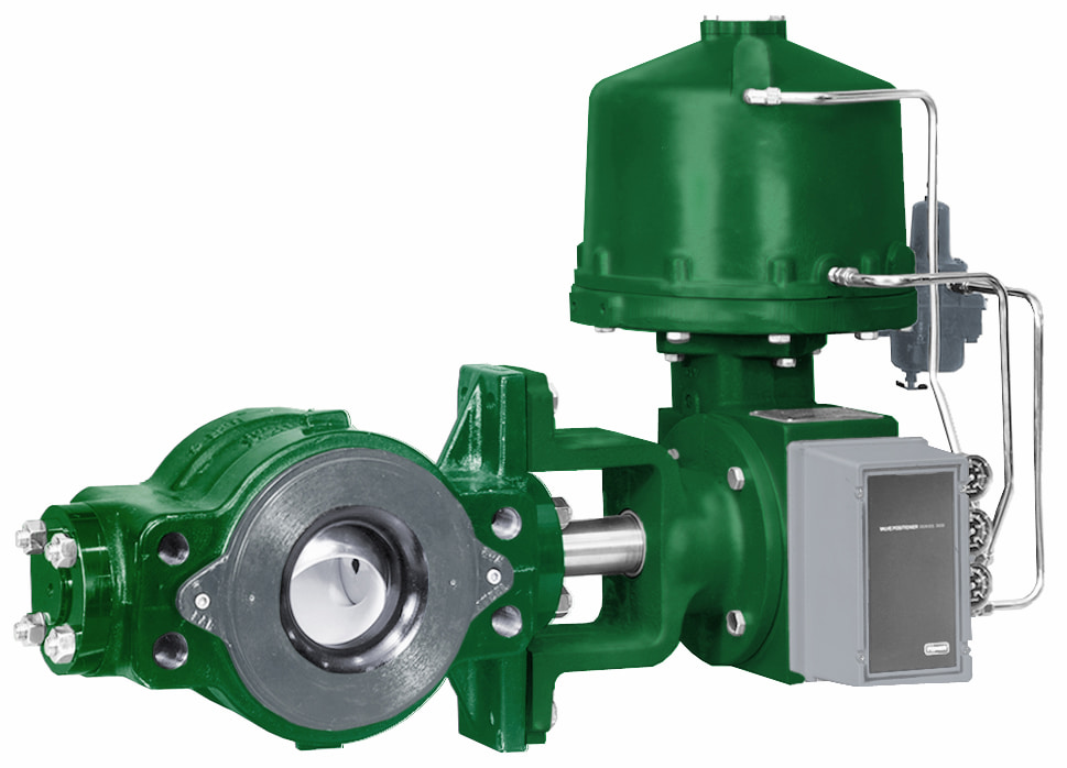

Using Digital Valve Controllers
With the advent of digitalization, a microprocessor-based digital valve controller can aid predictive maintenance by providing a valve degradation analysis, which is important for critical valves in control applications. This can reduce the amount of scheduled maintenance.
Installation does not affect the ability of a plant to migrate its FCE from a non-intelligent to a digital solution. All that is required is to switch the current conventional instrument to a smart, microprocessor-based intelligent instrument.
Microprocessor-based digital valve controllers have been used in the industry for some time. These smart positioners have fulfilled the traditional function of converting a current signal to a pressure signal to operate the valve.
They can also use digital communications protocols to provide simple access to the information critical to process operation, and to deliver the capability to integrate this information into a control system.
This means that the controller can aid predictive maintenance by providing a valve degradation analysis, which is important for critical valves in control and safety applications. This reduces the amount of scheduled maintenance.
By communicating through a variety of industry-specified protocols the controller links with the digital ecosystem of industrial internet of things (IIoT) to tie data, applications and organizations together.
The extensive diagnostics available to digital devices provide greater insight into the health of control valves, allowing potential failure conditions to be predicted before they occur.
A digital valve solution offers functionality from the outset, with auto-calibration, user-friendly configuration and a set-up wizard. It delivers accurate, precise control of the valve, with a range of instrument alerts available.
