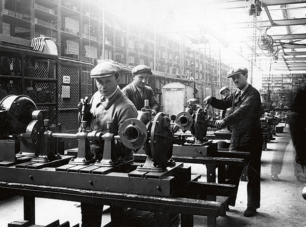

AUXERRE, France (June 3, 2013) – Mouvex, a part of Dover’s Pump Solutions Group (PSG), provides positive displacement pumps and compressors for the chemical, energy, hygienic and transport industries. The manufacturing facility is located about 100 miles southeast of Paris and was designed by an architect who was inspired by World War II airplane hangars. The unique facility was built
in 1970.
Originally used in the tar, asphalt and bitumen industries, Mouvex’s family of eccentric disc pumps has evolved. These pumps are ideal for handling any liquid efficiently and effectively, from water to slurries.
Mouvex is well-known as the birthplace of eccentric disc pump technology, an invention of its founder Andre Petit. Mouvex is French. It means eccentric movement. Petit invented this technology in 1906 as an effective alternative to the gear and lobe pump process. Petit placed a disc inside the pump cylinder so the eccentric disc would be more user friendly and maintain the integrity of the material. In addition to its headquarters in Auxerre, Mouvex has facilities on three continents (North America, Europe and Asia) through its parent company, PSG.
