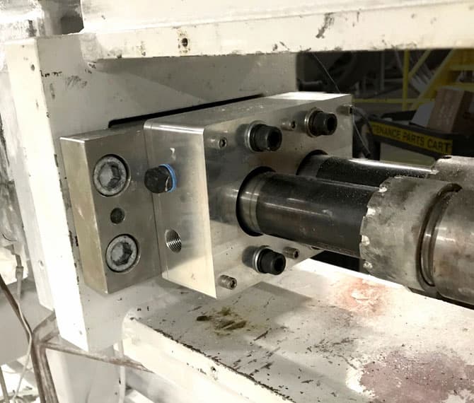

Moving to Noncontact
The alternative to contact sealing methods is noncontact sealing, which does not rely on any contact with the shaft to create a positive seal. These seals use air or inert gas to create a positive purge along the shaft, preventing contamination from entering and product from escaping, and are not affected by residual powders. Only a small amount of air is needed to maintain a pressure slightly above product pressures. The air is controlled by tight tolerances to the shaft and external airflow bushings. These seals allow gas or nitrogen to flow through them, better eliminating product buildup and maintaining the seal’s cleanliness throughout its life cycle. Since they have no contact with the shaft, these seals are non-wearing and permanent, reducing the need for costly maintenance, excessive downtime and replacement.
When selecting a noncontact seal for extruder applications, it can be helpful to select one that is designed to articulate, or adjust, to the aggressive shaft movements. Doing so will reduce the effects of radial runout, axial movement and angular misalignment while maintaining a positive seal in extreme conditions. Some noncontact seals can be designed for single- or twin-shaft arrangements and to fit into compact spaces.
Twin-shaft extruders are fundamental workhorses in the chemical processing industry. However, these machines can operate at maximum efficiency only with effective product sealing. Noncontact, fully articulating air seals help ensure extruders in chemical plants function to their highest potential. This technology is designed to help retain the product inside the vessel, minimizing the risk of leakage and reducing costs. They are designed to handle the challenging demands of twin-shaft extruders, helping ensure chemical plants can operate uninterrupted for longer.
