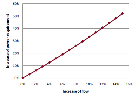

Pump Power Requirements
A sample calculation will help illustrate the savings potential. A pump's duty point is usually defined by the required flow and the related pressure. The latter is often indicated as head. For turbulent flows of Newtonian fluids, the correlation between pressure loss and head follows a quadratic relationship. Formula 1 applies to a closed pipe system with a static pressure of zero:
 H ~ Q2
H = Head
F = Flow
Formula 1. Dependency of head and flow in closed pipe system.
The power requirement of a centrifugal pump is defined in Formula 2.
P1 = Q • H • p • g
ηges
P1 =Power input
p = Density of the medium
g = Gravitational acceleration
ηges = Total efficiency of the unit
Formula 2. Power requirement of a centrifugal pump
Formula 2 implies a flow increase increases the power requirement by a factor of three. In other words, over-sizing the flow by 5 percent results in an increase of the energy demand by more than 15 percent (at constant efficiency). An increased flow of 10 percent raises the energy consumption to 30 percent.
Conversely, the influence of flow on the completion of the flow task depends in a high degree on the application. A heating system, for example, will reach more than 80 percent of its heating power if only half of the flow is provided.  In contrast, an undersized pump in the sewage or process technology can cause fatal consequences.
Figure 1. Increase of power requirement follows increase of flow in closed systems.

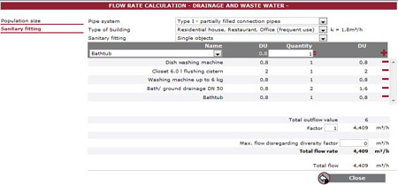

Domestic Wastewater
According to EN 12056, the flow rate for domestic wastewater resulting from drainage can be calculated by adding the run-off coefficients of several sanitary fittings, depending on the building type (see Formula 3).
Qww = K · √ΣDU
Qww = Wastewater drainage
K = Drainage figure according to type of building
DU = Outflow value of sanitary fittings
Formula 3. Calculation of wastewater drainage according to EN 12056
Pipe calculation software programs integrate this formula and the necessary coefficients (see Figure 2).
Calculation of flow rate for domestic drainage water according to DIN EN 12056
Figure 2. Calculation of flow rate for domestic drainage water according to DIN EN 12056

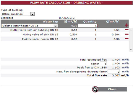

Drinking Water
To determine the flow rate for drinking water plants, DIN 1988 specifies water sampling points and building types (see Figure 3).
 Flow rate determination for the drinking water supply according to DIN 1988
Figure 3. Flow rate determination for the drinking water supply according to DIN 1988

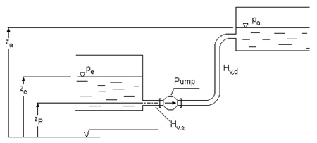

Total Head
The Bernoulli equation describes the equality of geodetic, static and dynamic energy. The total head consists of pressure losses and static head. The latter results from the geodetic height difference between suction and discharge fluid level and the static pressure difference. In closed cycles, the static part is zero.
Schematic demonstration of an unbranched pipe system.
Figure 4. Schematic demonstration of an unbranched pipe system.
Hges = pa - pe   + (za - ze) + Hv(Q) + va2 • ve2
       p • g                                                2g
pa - pe = Pressure difference between suction and discharge tank
za - ze = Hges = geodetic height
Hv(Q) = Pressure loss in dependancy flow rate
va , ve = Pipe length
Formula 6. Head of the plant
The term  in Formula 6 can be disregarded if the basic cross section on suction-side and discharge-side is sufficient, so the flow velocity is small. Furthermore, the pressure difference is not applicable in open tanks, which simplifies the equation to Formula 7.
Hges = Hgeo + Hv(Q)
Formula 7. Head of the plant with open tanks with a huge cross section
