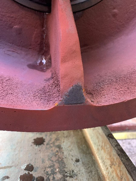

Contact damage on suction spacer  flow splitter
IMAGE 2: Contact damage on suction spacer flow splitter

During disassembly, the team noticed the suction spacer flow divider had damage indicative of contact with the barrel. This area is where the internal element extends farthest inboard and is meant to have a clearance to the barrel. The contact damage signaled possible discrepancies in the dimensions of the internal element that affected its axial position. The length from the end of the element to the suction spacer pressure face was measured on both the removed element and the replacement element. Comparison of these measurements confirmed that this dimension was longer on the removed element by approximately 1/8 inch.

The TFAs measured the corresponding dimension on the inside of the barrel to calculate the axial clearance of the replacement element. The as-found clearance was approximately 0.040 inches. When accounting for the expected thermal expansion of the element, this was determined to be too tight. The flow splitter was ground back 1/8 inch and reprofiled to the appropriate contour. The replacement internal element was installed in the barrel and the axial gap confirmed using a borescope.
