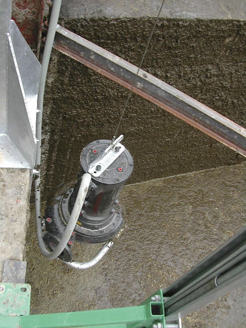

Wholly submerged in slurry, the two 18.5-kilowatt (kW) pumps at J.E. Carter & Sons were built to handle thick and highly corrosive fluids. The 15-kW mixers, designed with a two-blade clogging free propeller, benefited from a double mechanical sealing system between the electric motor and the surrounding liquid. A J.E. Carter & Sons pig farmer requested maintenance on his slurry pump, which was installed in 1993. Chris Carter, a farmer at Strathyre Farm near Preston in northwestern England, said that his slurry pumps saw the daylight for the first time after 21 years of submersion. Carter used the equipment to transfer pig slurry from one pit to another—and then to a 20-foot-high store.![Submerged slurry pumps](/sites/default/files/0914/submerged-slurry-pumps.jpg)

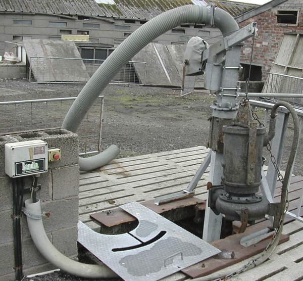

Engineers can easily under- or over-specify pumps when handling cow slurry. Carrying out a proper evaluation is critical because the content of slurry pits will vary depending on what a farmer’s cows eat. Lucerne (alfalfa), grass or maize silage will have a higher viscosity than green or cereal crops. Rainwater and yard water also come into play, as well as whether the cows are kept indoors or outdoors. Thick, raw cow slurry is unforgiving. If slurry is mixed improperly, then the water will be removed, leaving all the solids. Farms often add pumps when their existing equipment cannot handle their slurry. Either their equipment is under-specified, or the pipe diameter and/or pipe work has been inadequate. Pipe diameter and pressure are crucial. Small pipe diameters need more pressure to move the slurry, leading a bigger, more powerful pump to do a job better suited to one half its size. Too big a pipe diameter can result in not enough velocity. Farmers do not need to use the pit’s entire volume for pumping.![Pipe diameter and pressure are crucial to a slurry pump system](/sites/default/files/0914/slurry-pump-system.jpg)
