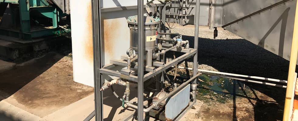

IMAGE 1: The fogging system is used to cool the inlet air of the process air compressor in the nitric acid plant. (Image courtesy of J.R. Simplot Company)

Inlet air fogging of the air compressor represents one facet of the plant’s drive to achieve a greater level of energy efficiency for the facility as a whole. Fogging consists of spraying tiny water droplets into the inlet air flow to cool the air by evaporation. This increases gas turbine power due to the fact that cooler air is denser. Therefore, the mass flow of the working fluid increases and the compressor becomes more efficient at lower air temperatures.
Modern fog systems allow a plant operator to control compressor output by adding or removing fog nozzle stages. It has been shown to produce good results in dry as well as humid climates.
How does it work? When a fog droplet is evaporating, the hot air molecules surrounding the fog droplet supply the heat of vaporization. Thus, the air is cooled as the droplet evaporates. Mass is transferred but energy is conserved, which means there is no change in the enthalpy—or total heat—of the air/vapor mixture. The heat used to vaporize the water droplet is latent in the air/vapor mixture while the sensible heat of the air is reduced. The output increase for a typical industrial gas turbine with 8 C of cooling is about 6%.
In a desert environment, power boosts of more than 20% have been recorded during the hottest parts of the year. At the plant, the engineer and production manager estimated the gains from using the fogging system on the air compressor vary from 5% to 10% depending on conditions.
What drove the adoption of this technology at the facility? The drivers were both energy efficiency and the demand for more fertilized production on warm days. The facility had a strong need for higher nitric acid production during the long California summer. The fogging system is used to cool down the inlet air of the process air compressor in the nitric acid plant.
The multistage process air compressor at the plant is driven by a steam turbine on one side and a hot gas expander on the other end. The steam turbine utilizes 550 pounds per square inch gauge (psig) process steam and the expander is fed by hot tail gas. Pressurized process air is supplied to the reactor to react with ammonia in the nitric acid production process. The more air mass delivered, the more ammonia is produced and the higher the nitric acid production will be. The compressor performance (factoring the mass flow of the air delivered at the discharge pressure) varies following the ambient temperature.
During summer months in the valley, the dry air temperature can rise up to 115 F at times, leading to lower daily production, yet product demand is high in those periods. Using the fogging system when the ambient temperature is above 78 F allows the inlet air to be cooled down significantly. This results in higher air mass delivered to the process and thus, higher production during summer months due to increased air flow and lower energy intensity.
