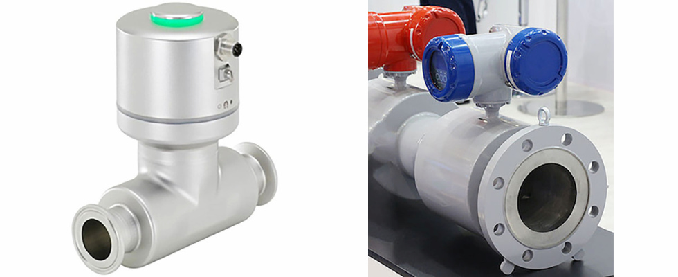

IMAGE 1: SAW flow meter (Images courtesy  of Tameson)
of Tameson)

Surface acoustic wave (SAW) flow meters
SAW flow meters (Image 1) are nonintrusive devices designed to measure the flow rate of fluids. These devices operate on the principle of generating surface acoustic waves along a piezoelectric material substrate. As the fluid moves across the sensor’s path, it affects the velocity and amplitude of these waves. The flow meter analyzes these changes in wave propagation, which are directly influenced by the fluid’s velocity, to determine the flow rate. These meters are favored for their nonintrusive nature, high precision and minimal maintenance needs.
