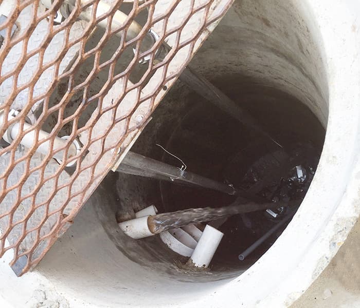

The Kentucky plant’s central sump collects washdown water from the other four sumps. The four sumps pump washdown water containing fruit debris into the central sump, which then pumps the slurry to a solids separator. The cast-iron submersible pump that had been operating in the central sump had become worn out and needed to be replaced. The food packaging plant’s maintenance manager considered the following requirements for replacing the pump: 1. The new pump would need to handle solids effectively. With several types of fibrous fruit, such as pineapple, apples and oranges, it was important that the pump not clog during operation. The submersible pump operating in the central sump was considered a critical pump and needed to operate reliably no matter how much fruit debris entered the sump. 2. The new pump had to be corrosion-resistant. The plant includes several food-packaging lines and all lines must be sterile for every food-packaging process. Before a line can start a new process, it is cleaned with special washdown chemicals that meet food-grade requirements. The cleaning solution is caustic; and while the cleaning chemicals are highly diluted by the time they enter the central sump, they would still have a corrosive effect on cast iron pump components, as had been the case with the old pump operating in the central sump. Over time, the caustic chemicals in the washdown liquid had worn out the cast-iron pump that had operated in that sump for many years. 3. The new pump had to be rated for 24/7 continuous duty. The food packaging plant runs 24 hours a day, and washdown occurs three times each day, every eight hours. If one building finishes a process and brings in a different product, the line must be washed down before the new process can begin. The pump in the central sump starts and stops frequently—often six to eight times a day—so it was critical to select a pump that could handle continuous pumping with numerous starts and stops. Ultimately, a submersible shredder pump was recommended and the following features were discussed with the maintenance manager:- To address the issue of fibrous solids in the sump: The pump is specifically designed for industrial shredding applications and uses an engineered tungsten carbide impeller. This impeller cuts against a spiral-shaped diffuser plate to continuously rip apart solids with 360-degree shredding action.
- To avoid clogging issues: The pump is designed with non-clog, single-vane impellers for high volume and lift performance. This submersible shredder pump has been proven to cut and pass solids up to 3.5 inches, while delivering high liquid volume at up to 700 gallons per minute (gpm). Any fruit shredded by the pump would be easily passed to the solids separator.
- To prevent corrosion and extend pump life: It is manufactured from 316 cast stainless steel, so all internal components of the pump exposed to the pumped slurry would stand up to the pH of the washdown liquid. The pump would have a longer life in this specific application because the impeller, wear-plate, oil housing, pump-housing and inner pump top are all made of corrosion resistant 316 cast stainless steel.
