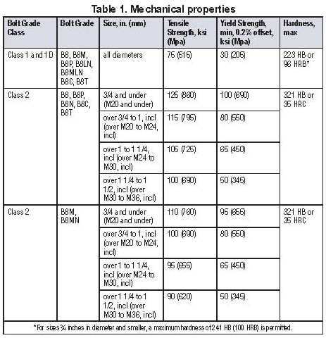

What is not always recognized is that every grade has two classes. The difference between the two classes lies in the strain hardening process. While this process will not affect chemical properties, it will have a significant impact on mechanical properties.
For example, bolt grade B8 Class 1 material which is carbide solution treated has yield strength of 30 ksi (205 Mpa) for all diameters, while B8 Class 2 which is carbide solution treated and strain hardened has a yield strength of 80 ksi (550 Mpa) (for diameters over 3/4).
Table 1, based on A193/193M values, shows stainless steel bolt grades and classes and their corresponding mechanical properties.
Table 1. Mechanical properties
Typically, strain hardened Class 2 stainless steel fasteners will provide better results for corrosive service because of their higher yield strength properties, especially when significant assembly load is required to generate the required gasket stress.
