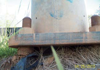

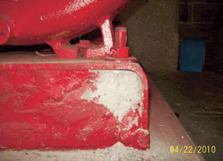

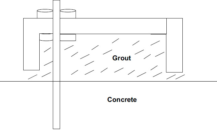

As can be seen in Figures 2 and 3, the major error was to use a nut below the base, directly on the anchor bolt, as a leveling shim.
Figure 2
Figure 2
Note that the upper nut was unable to tension the anchor bolts restricted by the bottom nut. Any further torqueing of the upper nut would result in a tighter squeeze of the plate between the nuts, but not the tightening of the baseplate to the grout as intended. Application of the grout in this case was completely useless.
The bottom nut prevented the top nut from properly applying tension to the anchor bolt, which essentially remained completely unstressed, with poor contact and pressure evenly distributed between the bottom of the baseplate and the grout. Installers commonly make this error, as noted by Corbin Spitzer.
With the baseplate essentially sitting with no pressure applied to the grout, it resonates in response to even small vibration forces. These noises may go unnoticed at a refinery or paper mill, but they are not acceptable for apartment residents trying to sleep.
As an additional test, the motor was decoupled from the pump and operated by itself. The noise remained, confirmed by switching the motor off and on. These vibrations were transmitted from the motor to the base, the base to the pump, to the connected piping and foundation and resonated through the building.

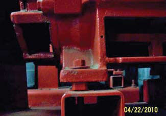

The bolts attaching the pumps to the base penetrated through the baseplate and were cemented in the grout. Using tubing to attach the pumps was also not helping.
Figure 3
Figure 3
Figure 4
Figure 4
A stiffer (thick) shim (bar) should typically be used, with smaller (0.010 to 0.001 in.) sets to make up the final difference of adjustment; these shims should also be wide enough to sit under the entire surface of the foot. Notice the improper use of a small nut between the bottom of the foot and the channel; this poor connection lacks a good contact between the entire surface of the foot and a shim.

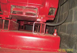

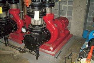

Whoever did the grouting job before must have been a telephone pole expert, as the static structures are grouted in this way (see Figure 5 and 6).
Figure 5
Figure 5
Figure 6
Figure 6
The telephone pole is sandwiched between the two nuts, which could be used as leveling device. However, I have not seen telephone poles jumping around too much, nor have I heard of vibration analysis applied to solve telephone pole vibration problems. Applying the art of grouting telephone poles to pumps could get you in trouble. It is better to follow proper installation techniques for rotating machinery.
