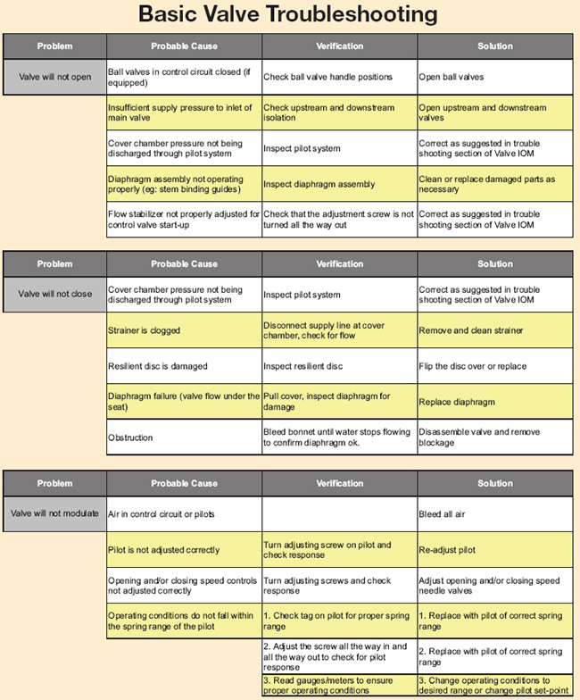

Basic Valve Troubleshooting

Air in the Pilot System
Air is the primary enemy in the pilot system because it will give false readings and cause poor valve operation. Bleed air from the valve bonnet. If the valve is equipped with a position indicator, on top of the position indicator is a bleed cock. Open the bleed cock slightly by turning the handle counter-clockwise.
Otherwise, bleed the air from the high point of the valve. If the water runs clear and no air bubbles are seen in the glass of the position indicator, close the bleed cock. If air is present (the water will be foamy white) run the water until the air is gone.
Strainers
Pilot systems rely on a supply of clean water, usually taken from the inlet of the valve. Either external or flush clean strainers can be installed. If an external strainer is installed, a simple occasional flush is a good idea. Normally, three to five seconds is sufficient to clean the strainer screen.
Experience will dictate if it needs to be flushed longer than this. A number of water utilities install a ball valve on the flushing plug of the strainer, allowing operators to give a short flush every time they are in the valve station. A plugged strainer can cause a valve to remain and result in major problems.
Reducing Pilot
Ensuring that the control valve pilot is operational is a simple task. As a cautionary note—before making any pressure adjustment—ensure that this is acceptable for the system and that any SCADA alarm controls that may be triggered are turned off. To exercise the pressure-reducing pilot, loosen the lock nut on the pilot adjusting screw and turn clockwise to increase the pressure 5 psi above the normal set point.
Check that the downstream pressure gauge is tracking the adjustments made. Then turn the adjusting screw counter-clockwise to reduce the pressure to 5 psi below the set point.
Finally, turn the adjusting screw clockwise to increase the pressure back to the original set point, and tighten the lock nut. If the pressure gauge does not move as you adjust the screw, either the gauge is bad or a pilot should be examined.
