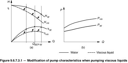

Q.  When pumping a liquid that has a viscosity greater than water, how can the effect of this higher viscosity on the pump performance be estimated?
A.  The Hydraulic Institute (HI) has developed a generalized method for predicting the performance of rotodynamic pumps on Newtonian liquids of viscosity greater than water. This is an empirical method based on the test data available from sources throughout the world. The HI method enables pump users and designers to estimate the performance of a particular rotodynamic pump on liquids of known viscosity, given the performance on water. The procedure may also result in suitable pump selection for a required duty on viscous liquids.
Performance estimates using the HI method are only approximate. The method does not take into account many factors of particular pump geometries and flow conditions. It is nevertheless a dependable approximation when only limited data on the pump are available, and an estimate is needed.
The performance (head, flow, efficiency and power) of a rotodynamic pump is obtained from the pump's characteristic curves, which are generated from test data using water. When a more viscous liquid is pumped, the performance of the pump is reduced. Absorbed power will increase and head, rate of flow, and efficiency will decrease.
When a liquid of high viscosity, such as heavy oil, is pumped by a rotodynamic pump, the performance is changed in comparison to performance with water, due to increased losses. The reduction in performance on viscous liquids may be estimated by applying correction factors for head, rate of flow, and efficiency to the performance with water.
Thus the curves of head and efficiency for viscous liquids (subscript vis) are estimated from the head, flow, and efficiency measured with water (subscript W) by applying the correction factors CH, CQ, and C?, respectively. These factors are defined in Equation 1.
Equation 1
Figure 9.6.7.3.1 (a) and (b) show schematically how the head, efficiency and power characteristics typically change from operation with water to pumping a highly viscous liquid.
Modification of pump characteristics when pumping viscous liquids..
The HI method explained in Section 9.6.7.4 of ANSI/HI 9.6.7 Effects of liquid Viscosity on Rotodynamic Pump Performance, is based on empirical data. It provides a way to predict the effects of liquid viscosity on pump performance with adequate accuracy for most practical purposes.

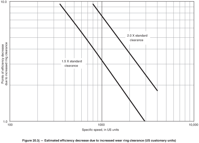

Q.  When maintaining centrifugal pumps, how important is renewing the impeller wearing ring clearance?
A.  Wear ring clearance can be very important if efficiency of operation is important. HI has published a new standard, HI 20.3 Rotodynamic (Centrifugal and Vertical) Pump Efficiency Prediction, which provides more detail. Figure 20.3j from that standard shows how much 1.5 and 2.0 times the standard clearance reduces the pump efficiency.
Estimated efficiency decrease due to increased wear ring clearance.
Other factors that influence efficiency are:
  • Type of pump
  • Surface roughness
  • Internal clearances
  • Mechanical losses
  • Liquid pumped properties
  • Special impeller designs
  • Impeller diameter trim
  • Thrust balance method
More details regarding these factors can be found in HI 20.3.
