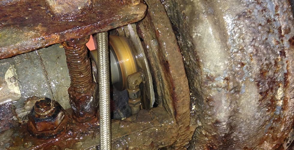

Slurry pumps are commonly used in the mining industry to transport abrasive and corrosive slurries throughout the mining process. Due to the harsh nature of these processes, slurry pumps are prone to leakage and failure, which can lead to high maintenance costs. Pump operators tend to focus their preventive maintenance efforts on the wet end of a pump (casing, impellers, etc.) because this is where most wear parts are located.
However, frequent leakage within slurry pumps and the wet environment created by flush water causes challenges for the bearing assembly, which can lead to substantial, avoidable maintenance costs. This article will discuss taking a proactive approach to effectively sealing slurry pump bearing assemblies and highlight the pros and cons of the most common types of bearing seals.

The bearing assembly is located only a few inches from the shaft seal. If that seal is leaking or flushed with water, the wet, abrasive material will travel along the shaft until it reaches the bearing seal. What happens next will depend on the type of seal used to protect those bearings.
The most frequently used bearing seal is a lip seal because it is inexpensive and readily available for purchase. It can be an effective short-term solution, but is prone to wear and tear over time, particularly when exposed to abrasive slurries. The gritty slurry is trapped underneath the lip of the seal and erodes the material, creating a gap for contaminants to easily enter the bearing frame. This will quickly degrade the quality of lubrication and cut grooves in the shaft or shaft sleeve, which eventually will need to be replaced.
Another commonly found sealing solution is an OEM-provided labyrinth seal. These seals rely on a close tolerance to the shaft which provides a direct leak path for contaminants to get into the housing. It is adequate for retaining grease lubrication but provides little resistance to any outside contamination ingress.
