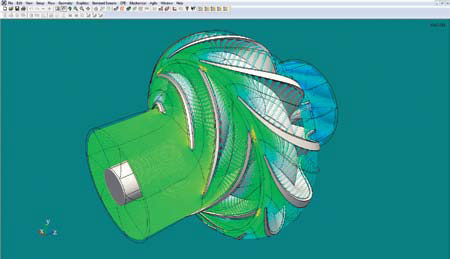

CFD of impeller and volute.
CFD of impeller and volute. Image courtesy of Concepts NREC.

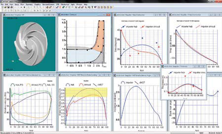

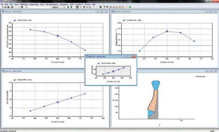

Meanline pump analysis.
Meanline pump analysis. Image courtesy of Concepts NREC.
Streamline curvature analysis of pump impeller.
Streamline curvature analysis of pump impeller. Image courtesy of Concepts NREC.

impeller and predict the path, velocities and pressure of the fluid moving through them provides an enormous opportunity for product improvement. Looking into the vane passages can be done by using a couple techniques. The first is through the use of streamline curvature calculations to predict the properties of the flow along discrete streamlines through the pump. Using multiple streamlines throughout the passage, the designer can estimate the velocities along the blade surfaces at multiple locations and produce an accurate profile of the flow properties. This provides feedback on blade loading, blade incidence angles and areas of possible stall or separation. The best part is that the feedback is nearly instantaneous, generally less than a few seconds of calculation time, allowing the designer to try multiple tweaks to improve blade loading, incidence and overall stage performance in a short amount of time.
When the stage appears to the designer's liking, the next step is to run the stage through a Computational Fluid Dynamic (CFD) analysis. Since we cannot implicitly solve the flow path as a continuous domain, this technique breaks the passageway down into a mesh of small blocks that a computer can solve iteratively. By solving all of the flow equations at each node point, we get a detailed prediction of the velocities, pressures and temperatures at each block. This allows the designer to verify the performance predicted by the initial meanline design or possibly show areas that could be improved before another CFD run.
CFD comes in many forms. Some codes are general purpose and use random, unstructured meshes. These meshes generally use the size of a feature to create the mesh around it, so short lines create high mesh densities, often in areas that are unimportant to the fluid's actual flow. These general purpose tools work well for stationary elements of the pump, but often struggle to deal with the interface between moving and non-moving parts. They also often require the entire pump to be modeled, resulting in enormous mesh sizes that take a considerable amount of time to run. Several codes have modules built specifically for turbomachinery analysis, and most of these use a structured mesh that allows the designer to solve only one blade passage of the pump. This drastically reduces the number of elements needed for the model, so more elements can be placed in areas of interest, and run times are much shorter. The results are often more accurate.

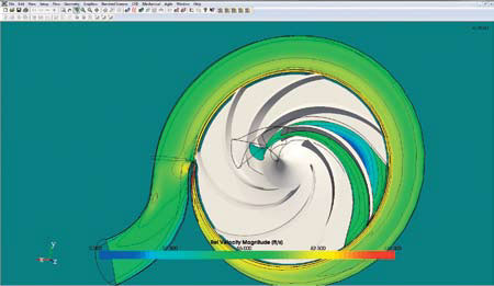

Relative velocity vector plot of a vertical turbine pump stage
Relative velocity vector plot of a vertical turbine pump stage. Image courtesy of Concepts NREC.
Beyond the impeller, CFD can be used to make drastic improvements in the stationary passages within the pump. Complex inlets for pumps like vertical in-lines or double suction horizontal split case pumps are extremely difficult to design without significant testing or the use of CFD. Many of these designs distort the flow into the impeller so much that they cause major reliability and efficiency problems, especially at off-design operating points. On one client design a few years ago, we redesigned the inlet of a vertical inline pump and improved the overall efficiency by 12 percent. The same logic applies to the pump's discharge side. I recently changed the volute tongue angle and exit bend radii on a top centerline discharge pump design and improved the efficiency of the unit by 3 percent.
