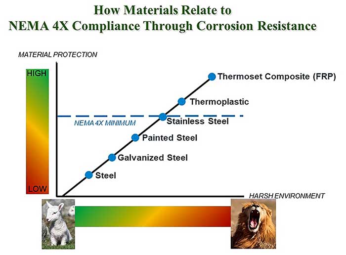

Image 1. Corrosion resistance of various materials (Images courtesy of Attabox)Influential Factors to Reduce the Failure of Enclosures
Often trade-offs between performance, acquisition cost and life cycle cost are made in the process to find the ultimate choice for a unique application. Consider these factors that influence the enclosure specification for applications and how each type of enclosure might stack up:- environmental considerations
- standards requirements
- physical characteristics
- electrical characteristics
- thermal management
- condensation
- cost solutions

Another factor that must be considered is how resistant the enclosure must be. Some factors to consider are:- corrosion and chemical resistance—especially when exposed to chlorine or acid
- flammability—understand Underwriters Laboratory (UL) 94-5VA or nonhalogenated options
- safety—nonconductive or will you need modifications to secure controls
- impact resistance—consider looking into modulus of elasticity ASTM D638
- sunlight, UV resistance—ask enclosure manufacturers to inform you of their UV protection available
- appearance—the finish or color choices; many new options for color are available

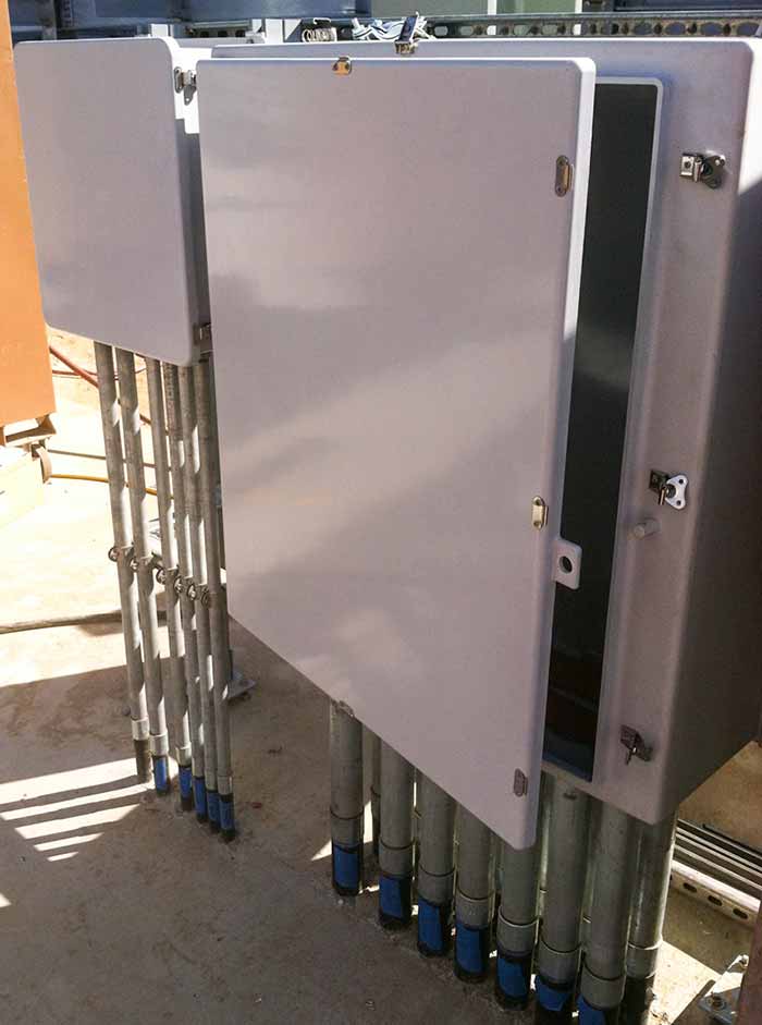

Image 2. Users should consider materials, rating standards and environment when choosing an enclosure.
