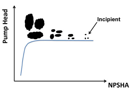

As suction pressure decreases (NPSHA reduced), incipient bubbles grow and eventually vapor lock the pump inlet (see Figure 4).
Figure 4. Development of cavitation

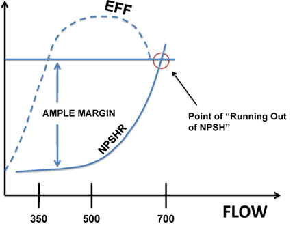

NPSHA must be greater than NPSHR for a pump to perform properly, i.e. deliver a TDH, at a given flow. The NPSHA margin (M=NPSHA-NPSHR) is important and needs to be at least 5-ft if possible (see Figure 5).
Figure 5. Ample margin of NPSHA is important for a complete range of operation-not just at a single rated flow point

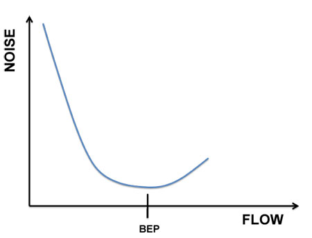

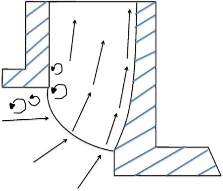

When a centrifugal pump operates below a certain flow point, flow recirculation in the impeller eye starts. This depends on several design factors, but recirculation generally begins below 80 to 60 percent flow, then becomes quite severe below 40 to 20 percent and appears as surge: violent, low frequency sound, accompanied by strong low frequency vibration of the pump and piping.
Figure 6. Problems arise when pump operates at too low flow
In addition to obvious mechanical problems with recirculation, the flow undergoes a complex vortexing motion at the impeller inlet (eye), with localized high velocities of the vortex causing horseshoe-looking cavitation damage, usually on the "blind" side of the blade, in contrast to to high-flow cavitation. Radial thrust load skyrockets at low flow, causes deflection of the shaft and leads to seal leaks, bearing life reduction and even shaft breakage.
