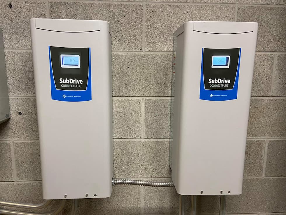

IMAGE 2: With more construction and renovation projects anticipated, VFDs allow for system scalability and provide room for expansion through built-in lead/lag and alternation.

In one such case, a middle school in the Midwest decided it was time to reevaluate its system and brought in a water well professional to assess its current submersible pumps. It discovered not only an aging system but an inefficient one: two six-inch, 100 gallons per minute (gpm) pumps were running in wells on a basic in-parallel setup supported by a bulky (yet undersized) 86-gallon tank. The design of the current installation was causing rapid cycling of the pumps and created accelerated wear on the overall system and its components, due in part to the frequency of starts and motor overheating. Ultimately, this led to increased maintenance of the pumps and motors. If the new system employed a similar design, it could lead to additional issues: premature motor failures, motor spline and bearing damage and decreased usage life of control components, such as pressure switches and relays.
The school needed a solution that would help regulate the motors, allowing them to operate more efficiently. Its engineering firm recommended a new duplex constant pressure water system consisting of a variable frequency drive (VFD) paired with two new submersible turbines, one for each well. Combined, this would optimize operation to meet water supply demands and the school’s irrigation system during critical in-class hours or idle time.
Over the long run, it would also mitigate rapid cycling on the system, preventing heat exposure and helping to alleviate future expenses related to service costs and downtime.
In addition to offering a solution to the district’s immediate challenges, the duplex pumping system delivered long-term performance and scalability features. With more construction and renovation anticipated, the system’s scalability provides room for expansion with built-in lead/lag and alternation capacity for up to eight drives.
By running the motor to meet the demands of the application, the VFD is expected to reduce energy costs associated with water supply and irrigation by up to 50% for long-term savings. Built-in diagnostics and protection—including surge, short circuit, underload and overheating controllers—ensure that maintenance is reduced for years to come.
