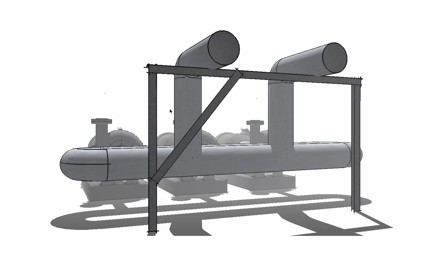

As the brewery placed the pumps into the operating configuration which gave them the most vibration, the company began to take various readings with their overall vibration meter. They noticed that taking measurements on the Pump #2 intake produced higher values than near the pump bearings. Pump #1 and #3 also exhibited vibration very near the level of Pump #2.

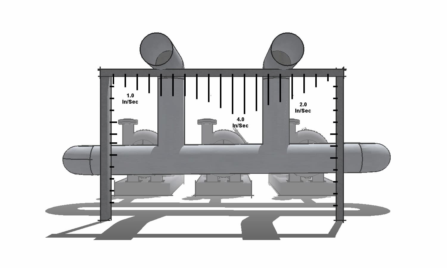

They shifted their attention to the intake manifold and found the readings at 1-in/sec. They moved to the two input feeds and again the vibration was worse, now up to 1.5-in/sec. As they followed the vibration, they found the highest amplitude to be 4-in/sec on a support beam that held the intake pipes (see Figure 1).
Figure 1
Figure 1
They proceeded to take measurements every 4-in along the support structure and plotted the results on graph paper (see Figure 2).
Figure 2
Figure 2
They discovered that the support beam was resonating at the vane frequency during the lowest running speed of the pumps. The beating shock wave created by the pump impellers was feeding back through the intake pipe system and exciting the support beam into resonance. A diagonal support was welded in to stiffen the structure and shift the resonance up (see Figure 3).
Figure 3
Figure 3
Thereafter, the vibration almost totally disappeared. Readings were below 0.1-in/sec at the support beam and 0.07-in/sec at the pumps. The brewery was very pleased that the solution to the problem turned out to be so simple. In this case, the vibration system company simply followed the most basic rule of vibration: "Follow the amplitude."
