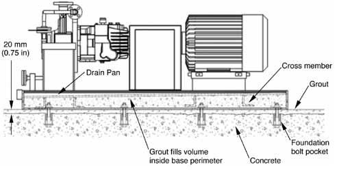

The grouted baseplate shown below is designed to allow the grout to be poured underneath the base. The grout placed inside the base contributes to the baseplate's installed rigidity and damping. See Figure 1.3.8.2.1a.
Figure 1.3.8.2.1a. Grouted baseplate, fabricated steel
The cross members used on the baseplate in Figure 1.3.8.2.1a are normally designed to lock into the grout and further resist any deflection or vibration of the baseplate. Typically, the cross member geometry chosen to achieve this is an L-section (shown), a T-section or an I-section.
If the baseplate is a closed design (i.e., the grout cannot be poured inside the baseplate perimeter due to the presence of a drain pan or deck plate), then grout and vent holes must be provided to allow the grout to be placed inside the base.
The grout used may be either cementitious or epoxy-based. The surface preparation required for a baseplate to successfully bond to the grout is different depending on which grout will be used. It is therefore important that the vendor and customer agree in advance which type of grout will be used.
The baseplate described and shown in Figure 1.3.8.2.1a is typical of a fabricated baseplate. Cast-iron baseplates are another type of grouted baseplate. The ability to integrally cast in features such as bracing, grout holes and sloping surfaces provides a highly functional and economical solution for many applications.

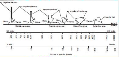

Rotodynamic pump designs are generally described as any of three types: radial flow, mixed flow or axial flow. For examples, see Figure 1.3.4.1. Radial flow impellers are designed so that the liquid exits purely radially, or perpendicular to the shaft centerline. They have lower specific speeds, in the range ns 10 to 50 (Ns 500 to 2,500), and most often are used for lower-flow, high-head applications.
As design flow increases, specific speed increases, and the impeller will become more axial in its configuration, with fluid flow in line with the shaft centerline. Fully axial impellers produce high flow rates with little head.
Between these two extremes, the liquid exit angle transitions from radial to axial as shown in Figure 1.3.4.1. These transitional designs are referred to as mixed flow impellers. They are used when the impeller specific speed is from 80 to 140 (4,000 to 7,000).
Figure 1.3.4.1. General impeller types
For more information on impeller design, see HI Standard ANSI/HI 1.3, Rotodynamic (Centrifugal) Pumps for Design and Application.
