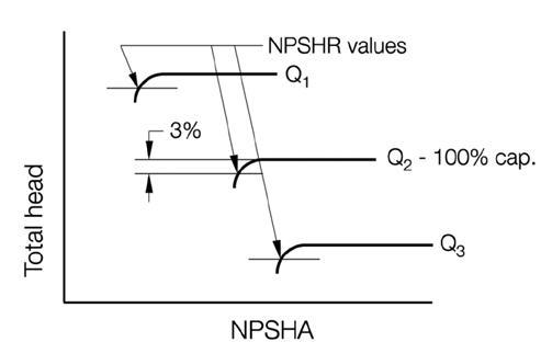

Q. Many pump manufacturers show the net positive suction head required (NPSHR) by a pump as a curve that declines in value as it approaches shut off or zero flow. Other manufacturers show this curve with a change in slope which increases in value at about 50 percent of best efficiency point (BEP) flow. Why do some manufacturers do this?
A. The ANSI/HI 1.6 Centrifugal Pump Tests standard defines the NPSHR as the value at which the total head produced by the pump is reduced by 3 percent at a constant rate of flow, as the net positive suction head available (NPSHA) is reduced. One method of determining the NPSHR is accomplished by conducting a series of tests with the rate of flow held constant and the NPSH available to the pump reduced. The result is a family of curves similar to Figure 1.122.
Figure 1.122. NPSH test with rate of flow held constant.
This test will usually produce lower values of NPSHR as the rate of flow is reduced. However, as the rate of flow approaches shut off, the flow at the impeller inlet begins to recirculate in a way that creates vortices between the impeller vanes accompanied by cavitation on the vane surfaces.
This can cause significant damage to the impeller and pump without reducing the pump total head in a measurable amount. Some manufacturers further increase the published NPSHR in this range to avoid such damage to the pump.
