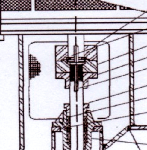

The solid shaft motor is more commonly used with short setting pumps up to 20-ft or 30-ft long. It usually does not have the down thrust capability of the hollow shaft motor. Axial adjustment of the pump rotor position is made with an axially adjustable rigid shaft coupling. This coupling also provides more direct support to the shaft in the stuffing box or seal area which improves mechanical seal operation. See Figure 2.8.
Figure 2.8—Solid shaft motor
