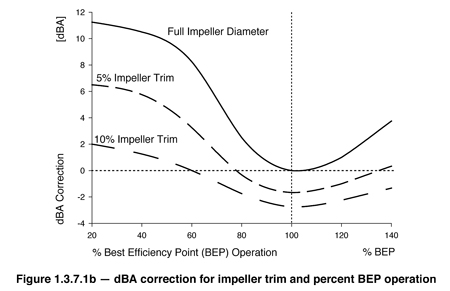

Impeller trim and operating point—Hydraulic noise typically increases with pump operation at flow rates well below or well above the BEP of the pump, or with an increase in the impeller diameter as shown in Figure 1.3.7.1.b. This correction factor is highly dependent on pump specific speed and pump construction. As a result, Figure 1.3.7.1.b should only be used as a guide.

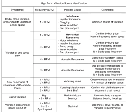

Q. What are the factors that cause excess pump vibration, and how can the specific cause be identified?
A.  The factors affecting vibration are:
  • Mechanical unbalance of rotating parts
  • Mechanical unbalance from abrasive fluids wear
  • Pump and driver natural frequency and resonance
  • Miscellaneous mechanical problems
  • Hydraulic disturbances
  • Hydraulic resonance in piping
  • Poor structural rigidity
ANSI/HI 9.6.4-Rotodynamic Pumps for Vibration Measurements and Allowable Values contains additional details pertaining to pump vibration.
