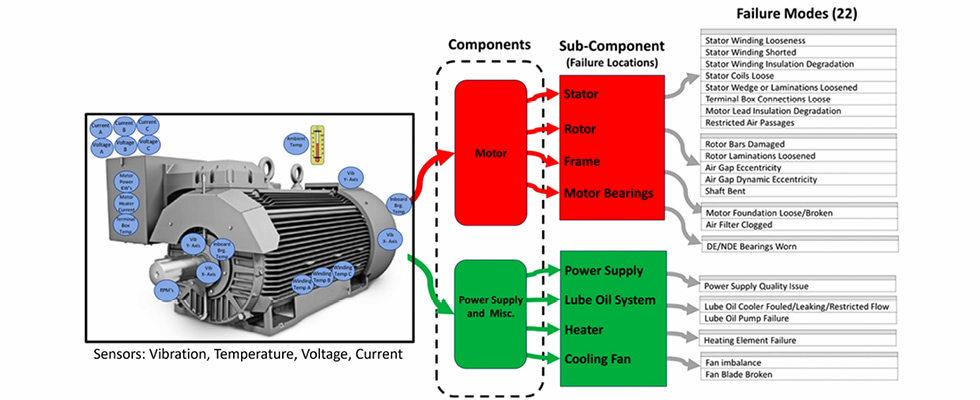

IMAGE 2: Failure modes of motor driver for pumps

Core to a pump predictive maintenance program is an asset catalog, the criticality or importance of assets to the business, probable failure modes and mitigating actions. These details are kept in an accessible, maintainable and digital location. The details are navigable by plant equipment hierarchy and by equipment type. Criticality and asset failure modes are most important (Image 2).
