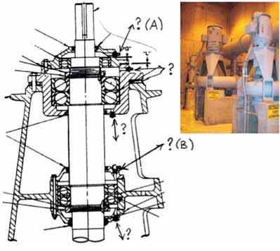

“Can you send me some photos of the installation and a sectional drawing?” I ask. “Also, tell me more about this problem. Is the pump running continuously, or with leads/lags?”

End-suction, vertically-mounted, raw sewage intake pum and drawing
Figure 1. (right) End-suction, vertically-mounted, raw sewage intake pump
Figure 2. (left) Drawing of the pump
After examining the images (Figures 1 & 2) that he emailed me, I called him back. “The lower housing seems to have a double-row, radial load bearing. The upper housing has two bearings: a tandem arrangement, 40-degree angular contact to take the main thrust, and a bumper single row bearing to take a start-up, transient up-thrust. I am confused about the greasing arrangement. The lower housing has a grease fitting (B) on the top, and a pop-up relief plug at the bottom. The top housing has two grease injection fittings (one at the top chamber and another between the bearings) and a pop-up relief plug at the bottom. Is that right?”
“That's right,” Jerry says. “That is what's bothering me. How do they make sure the bearings are not over-greased? The relief plugs are supposed to pop open and relieve the pressure if the chambers are full of grease. However, as soon as the pressure relieves, the pop-up relief closes, and the chambers remain mostly filled. This would make the bearings run hot. I also see clear signs of that because the whole housing is a mess—mostly at the top, but it's OK at the bottom.”

“They say the IOM procedure manual tells them to pump two strokes of the grease gun,” Jerry continues. “They showed me where they inject the grease: into A at the top housing and B at the bottom. They do this monthly per work order request. They have been doing it for about seven months, since the pump was installed.”
Two strokes are barely a fraction of an ounce. Through seven months, the number of strokes would be 14, which would perhaps be an ounce or two, not enough to even be close to over-greasing. This assumes that they did what they said and did not add a few more strokes just to be safe.
“What else do you see?” I ask. “Is the pump pumping OK? Is it vibrating?”
“It pumps fine. The operators are happy, and vibrations are low. I just took measurements myself. The issue is that the housing definitely looks over-greased, but only at the top side of the housing.”
Jerry pauses thinking, “It would make sense according to the fittings. Grease cannot be injected into the bottom portion of the upper or lower housings, other than relying on the dripping of grease through the entire row of bearings.”

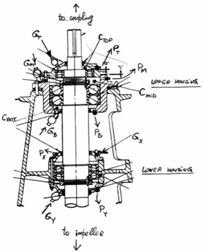

Jerry's next action was to modify the housings, to make sure each chamber had its own way in (grease fitting) and its own way out (pop-up plugs). The pop-up, plugs would need to be removed at each re-greasing. After 15 to 30 minutes of pump running, replaced.
Pump with injection ports labeled
Figure 4. The pump with injection ports labeled
Ctop, Cmid and Cbot are cavities on top of the top bearing at the upper bearing housing. Gt, Gm and Gb are injection ports (grease fittings), and Pt, Pm and Pb are pop-up relief plugs (also served as relief plugs to be opened during relub). Similar designations are shown for the lower housing (G = grease in, and P = pop-ups). The logic made too much sense, and the plant maintenance did not buy it. Why waste so much grease every month? “Is there a simple method?” they had asked Jerry. There is indeed. Perhaps not perfect, but a compromise.
