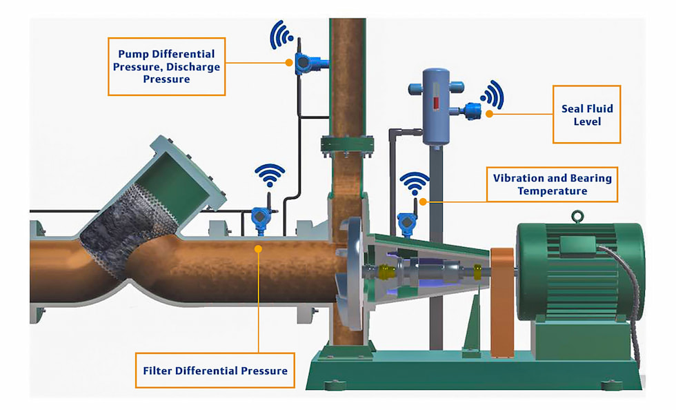

IMAGE 1: Examples of problems that can impact a pump (Image courtesy of Emerson)

The impact from a failure can be significant but some options will dramatically mitigate risk. One option is a continuous pump health monitoring system that enables users to detect and predict problems based on accurate, real-time data collected from the pump and sent wirelessly to the operator’s device. Alerts from the continuous monitoring system can be integrated into a computerized maintenance management system (CMMS) to drive automatic work orders.
Continuous monitoring allows for greater visibility into process and equipment conditions. The question is, how does a facility make that happen without an investment in new equipment, cabling and other infrastructure items, as well as training on how to work this new setup? The answer is found in wireless sensor networking technology and existing sensors, which feed all of that data into a continuous monitoring software package. Wireless sensors allow for a cost-effective multimeasurement approach:
  • Using existing infrastructure provides value from the wired data being collected.
  • Predictive analytics ensure problems are caught before they lead to process upsets.
Wireless sensor networking technology makes it possible to build a wireless network within a facility without the cost of additional wiring. Devices that measure such things as acoustic interference, vibration, pressure and temperature, and level metering are available with native wireless sensor networking technology connectivity supporting smart transmitter capabilities without the need for power or networking cabling.
