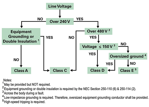

UL Standards for Industrial GFCIs
Reliable GFCIs suitable for industrial use did not exist until recently. Last year, UL published UL943C, Special Purpose Ground-Fault Circuit-Interrupters. It covers industrial GFCIs that operate on circuits up to 600 volts, will not trip until leakage current exceeds 20 milliamperes (comparable to the European standard of 30 milliamperes), and are suitable for industrial installations. GFCIs built to the new standard will increase reliability as well as protection. UL943C separates industrial GFCIs into Classes C, D and E:
  • Class A, under UL943, is for residential applications, with voltage of 120 or 240 in single-phase installations, with a 6-milliampere trip level (which is too low for industrial use).
  • Class C is for use in circuits with no conductor more than 300 volts alternating current (AC) to ground where reliable equipment grounding or double insulation is provided.
  • Class D is for use in circuits with one or more conductors more than 300 volts to ground and with oversized grounding to prevent the voltage across the body from exceeding 150 volts during a fault.
  • Class E covers equipment similar to Class D but with high-speed tripping required. Therefore, the oversized ground of Class D is not required.
Figure 1 shows how to choose the class of GFCI for a particular application.
How to choose the class of GFCI for a particular applicationFigure 1. How to choose the class of GFCI for a particular application
While UL 943C has been released, the National Electrical Code (NEC) does not yet require the use of industrial GFCIs. It does, however, require the use of GFCIs for specific applications. As awareness of the new UL standard increases, acceptance will also increase, and some industry players expect the NEC to be updated to require GFCIs in more applications.

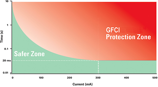

All GFCIs follow a trip curve defined by UL943 and shown in Figure 3. At 300 milliamperes, the GFCI must trip within 20 milliseconds, while smaller currents take longer. A current of 20 milliamperes corresponds to a trip time of about one second.
All GFCIs follow a trip curve defined by UL943. At 300 milliamperes, the unit must trip within 20 milliseconds, while smaller currents take longer. A current of 20 milliamperes corresponds to a trip time of about one second.Figure 3. All GFCIs follow a trip curve defined by UL943. At 300 milliamperes, the unit must trip within 20 milliseconds, while smaller currents take longer. A current of 20 milliamperes corresponds to a trip time of about one second.

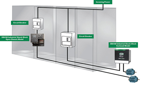

How Industrial GFCIs Are Installed
Installing an industrial GFCI is relatively simple. They are much larger than their residential cousins and are mounted inside an existing electrical cabinet or other piece of equipment. They may also be ordered with their own enclosures and mounted like an electrical panel (see Figure 4). For temporary applications, the industrial GFCI may be located on a wheeled cart to make it easy to move to temporary locations.
Figure 4. Installation diagram for industrial GFCIsFigure 4. Installation diagram for industrial GFCIs
