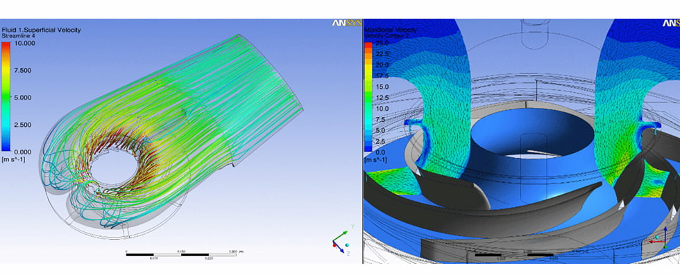

The finite element method (FEM) and computational fluid dynamics (CFD) analyses were employed to check and optimize the pumps’ design. FEM analysis, which simulates structural response to stress, was applied to the pump and baseplate to enhance the skid’s dynamic behavior across the entire design speed range. This analysis also contributed to the design of the pump casings and tie bolts to withstand the most extreme operating conditions in terms of pressure and temperature. The impellers, diffusers and casings were developed using CFD analysis, which models fluid flow, combined with in-house prototype testing. The result of these efforts was an optimized first-stage impeller, engineered for low net positive suction head required (NPSHr) in both single and double suction configurations, with subsequent stages optimized for maximum efficiency.

IMAGE 5: CFD analysis for optimization of design of impellers, diffusers and casings
