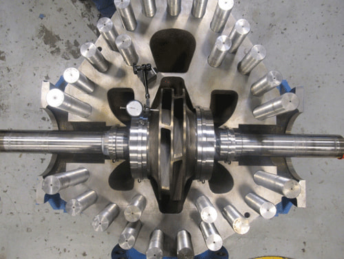

IMAGE 1: A pump rerate project is often a collaborative endeavor (Images courtesy of Sulzer)

Good communication is critical. Often a rerate project is a collaborative endeavor, and along with the end user and the shop doing the actual work, there may be an engineering, procurement and construction (EPC) company, contractors and other third-party vendors involved. Therefore, careful planning during the initial stages goes a long way in ensuring a successful rerate. While this is an easy statement to make, what should one consider when planning? Here are a few areas where challenges may come up during rerate projects.
