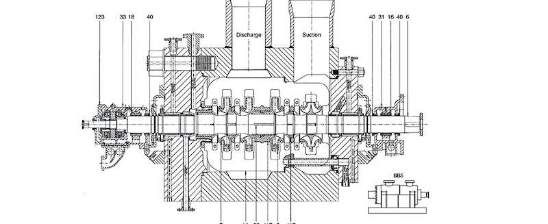

When should I measure shaft vibration on my pump?
Hydraulic Institute
Shaft vibration is most commonly measured on large pumps with sleeve bearings and done using proximity probes mounted near the bearing. Shaft vibration is not commonly measured on pumps with rolling element bearings.
When shaft vibration is measured, there are typically two proximity probes radially mounted 90 degrees apart at the inboard and outboard sleeve bearings (Image 1, items 16 and 18) so the centerline and orbit of the shaft can be plotted. This allows the vibration monitoring system to determine if shaft displacement exceeds the sleeve bearing clearance. The proximity probes and monitoring can be part of a safety system that senses when displacement exceeds a set value and can alarm or shut the equipment down to prevent a more significant failure.
IMAGE 1: Between bearing pump with sleeve bearings (Items 16 and 18)
