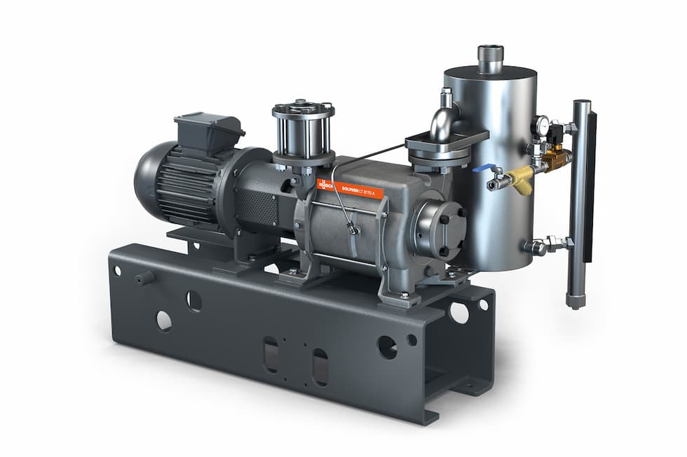

IMAGE 1: Liquid ring vacuum pump (Image courtesy of Busch  Vacuum Solutions)
