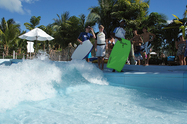

Typical wave machines require multiple pumps to provide tens of thousands of gallons of water per minute with total motor power requirements from 300 horsepower to 650 horsepower. Depending on the manufacturer, such pumps can be installed either vertically or horizontally.

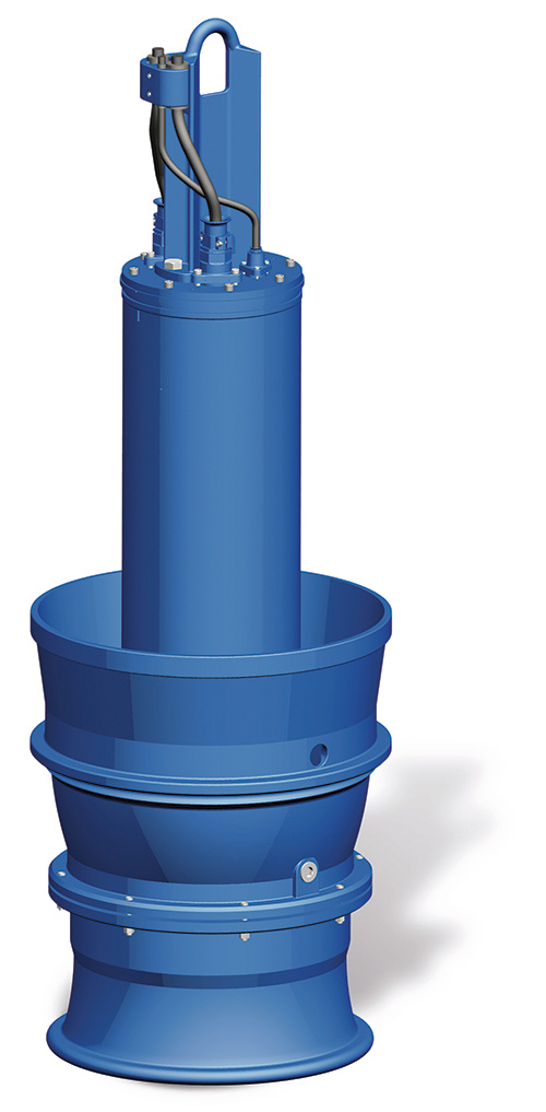

Tubular casing pumps used for the wave machines provide good performance in both horizontal and vertical configurations. However, when space allows, vertical installations provide superior hydraulics, mechanics and serviceability. While each wave can have a different specification determined by preference, the designs are created by trusted engineering solutions to guarantee efficiency, safety and overall success.

Tubular casing pump

Typical wave machines require multiple pumps to provide tens of thousands of gallons of water per minute.
