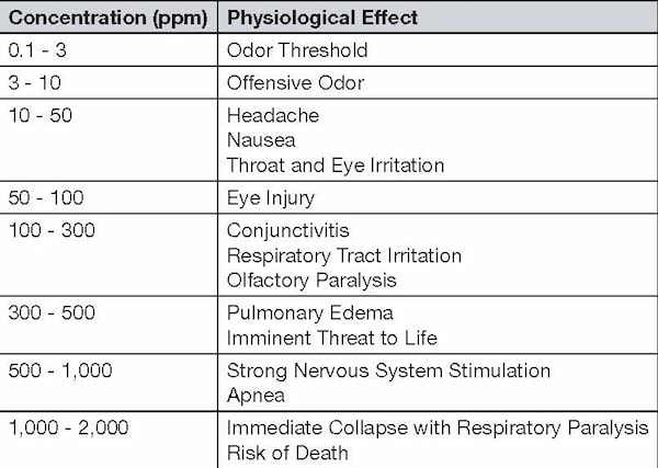

Following its generation, hydrogen sulfide can be released into the atmosphere (see Equation 4) and find its way to receptors through manholes or other junctions of the atmosphere and collection system, at which point it is an odor concern. Hydrogen sulfide is a colorless gas that has a characteristic rotten egg odor, is highly toxic and is very corrosive to certain metals. It is heavier than air, meaning it can accumulate in wells, manholes and other similar locations that do not have good ventilation. Its effect on humans, at varying concentrations relative to ambient air, is shown in Table 1 [EPA, 1985].
Table 1. Hydrogen sulfide health effects at varying concentrations
Hydrogen sulfide becomes a corrosion issue when it comes into contact with moist concrete or steel, among other metals, in the presence of oxygen, even at very low gaseous concentrations. Conditions such as these are fairly common in the head space of some pipes, as well as at manholes, lift stations and other areas in which the collection system is provided with easy access to atmospheric oxygen. Bacteria in these areas are able to convert the H2S into sulfuric acid (H2SO4) which then begins to react with the infrastructure in a destructive way.
