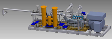

Many firms use advanced 3-D computer aided design (CAD) product engineering modeling software programs to draft systems and modules. The images provide a visual scope of supply, component verification and general arrangement layouts.
A fluid handling system manufacturer used such a program to demonstrate how an integrated system with fuel filtration, main fuel oil injection pump, preferred electric motor, instrumentation, piping and components would streamline secondary fuel delivery. The 3-D CAD renderings significantly enhanced communications with the turbine manufacturer throughout the project.
This approach also had the benefit of reducing the number of shop engineering change notices, which in turn reduced the total manufacturing cost. Another advantage was that modules could be designed to fit standard size intermodal freight shipping containers, which lowered logistics costs. (See Figures 1 and 2.)
Figure 1. 3-D modeling

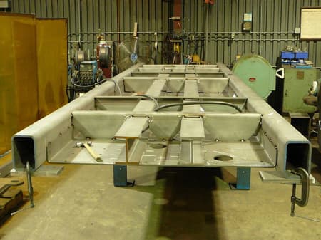

Figure 2. Intermodal baseplate. The fuel oil system developed for the gas turbine manufacturer was installed on this 20 ft. base , which occupies less space than the equipment typically used by power generation plants and fits into a standard intermodal container for shipment.
