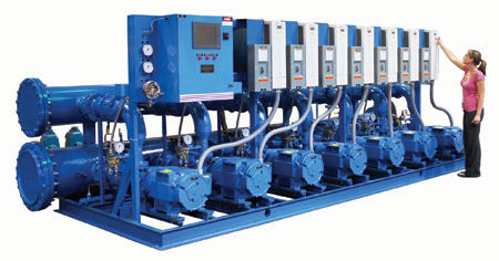

 Pictured is a packaged domestic water pressure booster system for Chicago's McCo
Pictured is a packaged domestic water pressure booster system for Chicago's McCormick Convention Center that increases the pressure provided by the City's water system and satisfies the potential peak flow demands of the facility. Photo courtesy of Metropolitan Industries, Inc.
