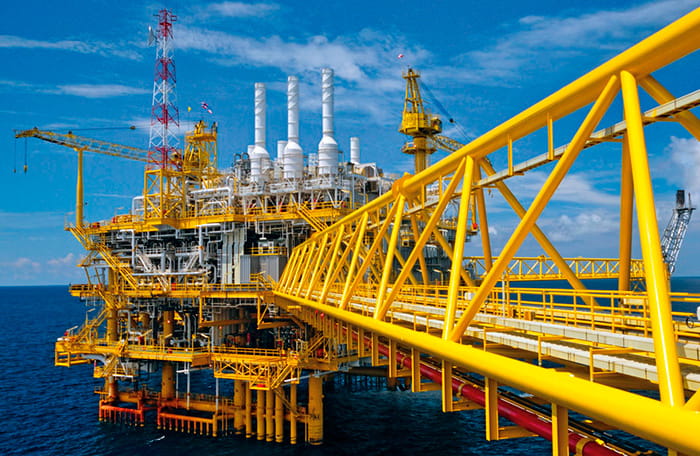

Image 1. Oil and gas engineers must place close attention to the hydraulic pressure their systems are under due to the extreme conditions. (Images courtesy of Trelleborg Sealing Solutions)Offshore Hydraulic Sealing
The same principles apply to hydraulic sealing whatever the application, but offshore sealing systems must stand up to extreme pressures, destructive process chemicals and marine environments. In addition, sealing materials need to meet industry standards such as American Petroleum Institute (API) and NORSOK while being able to respond to an ever-changing technological horizon. As wells increase in depth and processing grows more aggressive, the working conditions for seals and bearings become more demanding. Avoidance of downtime is a key aspect as the costs associated with this in the oil industry can be huge. Close collaboration between operators and equipment and sealing suppliers is vital in ensuring long seal life and minimized downtime. One of the most important factors in successful seal specification is understanding the conditions in which the equipment will operate. This way, the sealing system can be matched to specific requirements in terms of pressure, temperature and, most significantly, media compatibility. Process chemicals can destroy seal materials if not correctly specified. In terms of materials, options include basic acrylonitrile butadiene polymer (NBR), perfluoroelastomer (FFKM) compounds or polytetrafluoroethylene-(PTFE)-based seals, which compatible with virtually all media and polyethylenes. Seal geometries are as important as material because each seal within a hydraulic sealing configuration has a specific job to do. The geometries, which have evolved and been enhanced over many years based on application experience, allow the seals to provide a specific function within the sealing system to meet the varying demands of differing applications. For instance, downhole tools need solutions that withstand extreme temperatures and aggressive media. They require a sealing system to give extended life to allow oil and gas extraction from the lowest depths; reliability and leak-free operation are critical. For tensioner cylinders, a 20-year or longer maintenance-free seal life is sought to prevent downtime and revenue loss. In hydraulic swivels, increasing speeds and pressures call for innovative and unique seal designs that give low-friction operation.Proven Solutions
