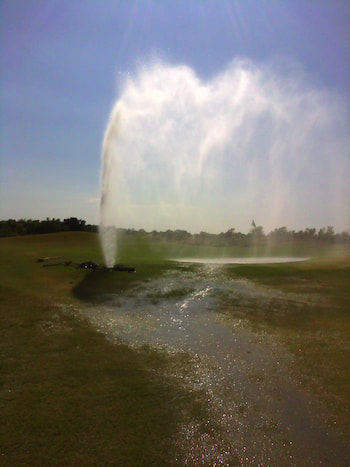

Damage can occur if a leak in a remote area goes undetected and the water is not shut off immediately.
Geyser on Green 17--damage can occur if a leak in a remote area goes undetected and the water is not shut off immediately. Photo courtesy of Bailey Ranch Golf Club, Owasso, Okla.

When a VFD pump system is running PID (constant pressure) control and the piping becomes damaged, the ideal scenario would be to turn off the pump shortly after the detection of a broken pipe. If the pump were to continue running with damaged piping at full speed and maximum gallon-per-minute volume for a long period of time, the damage that would occur from flooding could be extensive (Figure 1).

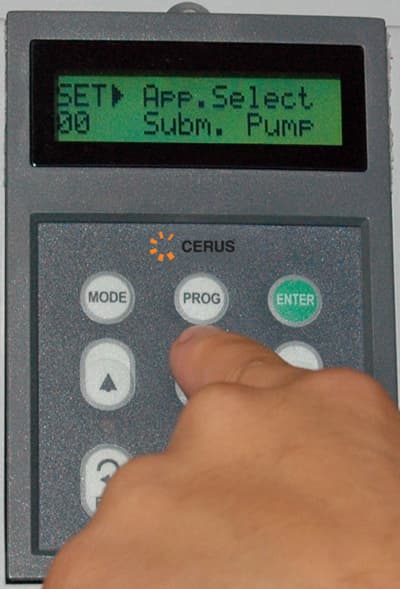

Some VFDs provide the ability to set parameters in application-specific units. For example, pressure set points can be entered in psi, WC, M, bar, mbar, Pa, and kPa. To set up the pipe-fill limits, users monitor the pressure with the VFD during testing and then set the appropriate Pre-PID exit level in the unit of choice.

The keypad on this VFD is used to select setup options, including the units in which pressure will be displayed.
Figure 3. The keypad on this VFD is used to select setup options, including the units in which pressure will be displayed.
