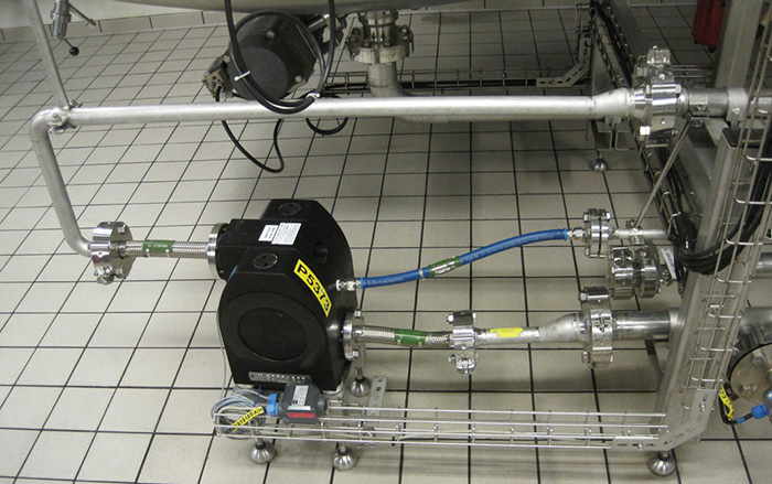

Image 1. Solid-body plastic AODD pumps are a proven choice for potentially explosive chemical applications. (Images courtesy of Almatec)Image 1. Solid-body plastic AODD pumps are a proven choice for potentially explosive chemical applications. (Images courtesy of Almatec)

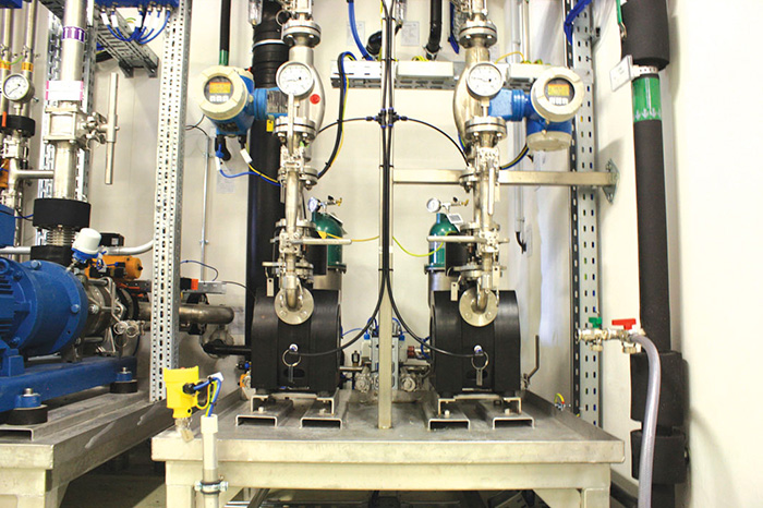

Image 2. These AODD pumps are machined from solid plastic blocks of polyethylene (PE) or polytetrafluoroethylene (PTFE).Image 2. These AODD pumps are machined from solid plastic blocks of polyethylene (PE) or polytetrafluoroethylene (PTFE).
Pumps that are machined from a solid block of PE or PTFE, on the other hand, can provide more weight, wall thicknesses, chemical compatibility and sealless design along with the ability to withstand potentially explosive atmospheres. Pumps that are constructed of polyethylene offer excellent abrasion-resistance. One line of plastic solid-body AODD pumps has been shown to last seven times longer than pumps made with polypropylene—while still having similar chemical-resistance characteristics—and are said to be 1.6 times more durable than stainless-steel pumps. Solid PE may also deliver better sealing, higher static weight, smoother operation and better torque retention than other popular materials of construction. Similarly, PTFE has a nearly universal chemical resistance.

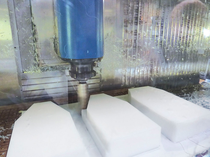

The machining of a solid block of PE or PTFE is relatively economical because of advanced modern computer numerical controlled (CNC) technology, enabling far tighter tolerances to be achieved than those possible with many injection-molded parts, which require tightening straps and seals to compensate for mechanical variations from surrounding parts. The occurring loads in a solid-body AODD pump are absorbed by the component itself with no necessary external reinforcements. This allows the external unit to be designed without any metal at all, which reduces the risk of corrosion. An AODD pump with a solid-block design is more capable of withstanding external shocks, such as those created by improper handling. A solid-body pump is also capable of absorbing the loads created by the connecting pipes. Solid-body AODD pumps constructed of PE/PTFE-conductive plastic are intrinsically safe and meet the operational requirements of the European ATEX 94/9/EG directive, as well as the U.S. Food & Drug Administration for hygienic-manufacturing operations that take place in potentially explosive atmospheres.
