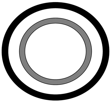

Figure 1a. Concentric rotor end view

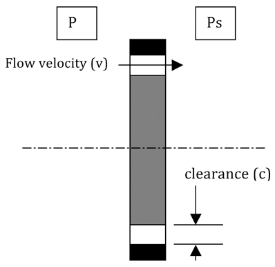

Figure 1b. Concentric rotor side view. Differential pressure from discharge pressure (Pd) to suction pressure (Ps) produces an axial flow of liquid across the wear rings.

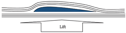

Figure 2. The airplane wing. Higher velocity over the top of the wing results in an area of relatively lower pressure. Lower velocity under the wing results in a relatively higher pressure. The result is upwards force (lift) that allows the airplane to fly.

The stability generated by the wear rings is generally referred to as the Lomakin Effect, which is driven by the differential pressure across the rings. The wear ring is a barrier between discharge pressure (Pd) and suction pressure (Ps). The differential pressure across this interface creates an axial flow velocity as shown in Figures 1a and 1b.

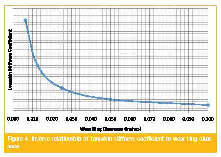

The Lomakin Effect can sometimes be confusing because it encompasses two separate phenomena that occur at the wear rings: damping and stiffness. Damping does not directly prevent shaft deflection, but minimizes rotor response to excitation forces—much in the same way that shock absorbers result in a smooth ride in a car. Reduced clearance increases damping and results in a more stable rotor (Mancini).
Reduced clearance also increases shaft stiffness. The additional stiffness is derived from a positive corrective force which occurs whenever the rotor becomes eccentric. It works similar to an airplane wing (Figure 2), where the difference in relative velocities creates a force due to differential pressure.

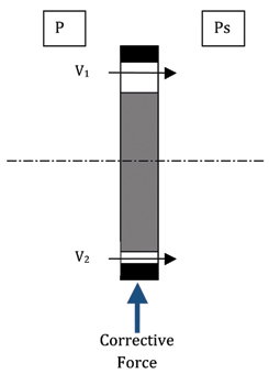

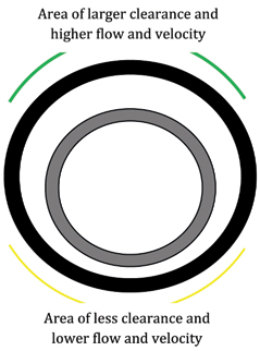

A similar situation occurs when a centrifugal pump experiences shaft deflection. The pump rotor is exposed to multiple loads such as the weight of the rotor, hydraulic forces and unbalance to name a few. The result is shaft deflection and a rotor that runs off-center (Figure 3a and 3b). When this happens, the axial flow across the wear ring changes, with higher flow and velocity on the side with larger clearance and lower flow and velocity on the side with less clearance. The stiffness generated from these forces is known as the Lomakin Effect.

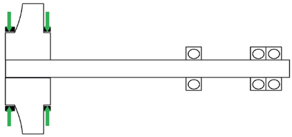

Perhaps most important, the stiffness and damping are located at the impeller where the pump has no bearing support. This strategic location gives the Lomakin Effect a great
deal of power in minimizing shaft deflection (Figure 5).

Figure 3a. (top) Non-concentric rotor and view. Higher axial flow will occur in areas with more clearance; lower axial flow will occur in areas with less clearance. Figure 3b. (bottom) Non-concentric rotor side view. The relative difference in velocity (V1 > V2) results in a net corrective force on the rotor - i.e. The Lomakin Effect.

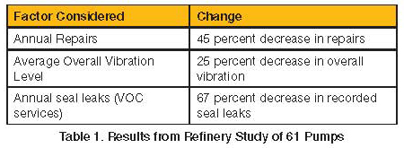

The reliability impact from reduced wear ring clearance has been documented in numerous case studies during the past two decades. A recent study looked at repair data, vibration data and seal leakage data for 61 pumps installed in a North American refinery. The data was compiled for several years before the installation of composite wear rings with reduced clearance and for an equal period after the conversion (Aronen, Boulden, Russek). The results are shown in Table 1.
After the conversion to composite wear rings with reduced clearances, the pumps were significantly more reliable, ran with lower vibration and experienced fewer seal leaks. Several other individual case studies have shown similar results. Studies of older pumps have shown overall vibration levels reduced by as much as 90 percent (Komin, 1985). Other studies have shown increased life and/or reduced vibrations in hydrocarbon (Pledger), boiler feed water (Aronen, Plaizier, Sinclair) and condensate services (DuPont).

Figure 5. Lomakin-induced stiffness is located at hte impeller where the pump needs it.
