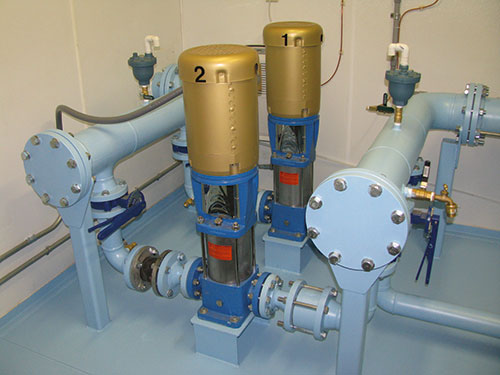

Clark Patterson designed the new water treatment system, which included two wells, No. 4 and No. 6; a chlorination system; a pumping system; and a new 30,000 gallon storage tank (see Image 1). Since this system’s source was a well, it has filtration avoidance, and chlorination is the only treatment. Space for a new cartridge filtration system was designed within the water treatment plant, in case the wells are reclassified in the future.
Image 1
Image 1. The water treatment plant included pressure-maintaining
booster pumping and metering capabilities.
