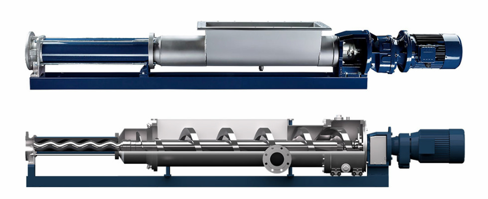

Although they handle changes in viscosity well, there are still challenges when the product is so thick it will not naturally flow into the cavity opening. To combat this, manufacturers have modified the inlet side of the pump with hoppers and augers to “stuff” the product into the cavity. This ensures a high-intake efficiency, regardless of the flowability of the product.

IMAGE 1: Open hopper style progressive cavity pump (Images courtesy of SEEPEX)
IMAGE 2: PC pump with ribbon auger for conveying products that tend to bridge (shown with optional maintenance feature for access to drive joint)
