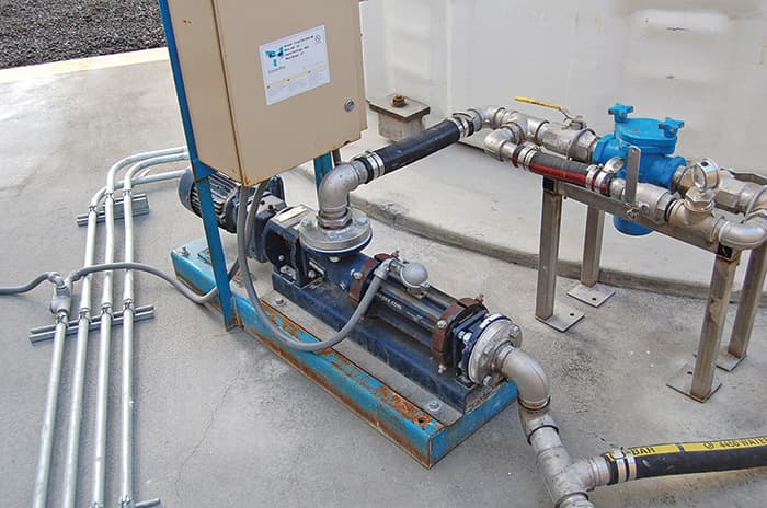

At a power plant site in the U.S., Fuel Tech was cost-effectively and safely reducing slag buildup in multiple coal-fired power plant boilers through the use of a proprietary chemical injection process. One chemical used in this process is magnesium hydroxide. Magnesium hydroxide is an inorganic compound that presents no hazard to the environment because of its mild reactive pH and solubility. It is a safe alternative to harsh chemicals with a relatively low environmental impact. In this installation, Fuel Tech experienced difficulties with the pumps that transferred the magnesium hydroxide because of its thick and chalky properties.
The Solution
In the end, a range of progressive cavity pumps with smart conveying technology proved to be the most effective, reliable and economical solution, while providing the easiest maintenance and longest service. They could handle temperatures between 32 F and 113 F, pressures up to 60 psi, and a flow rate between 7 and 14 gallons per minute (gpm). Offering controlled flow with minimal pulsation, this pump conveyed the magnesium hydroxide slurry gently from one tank to the next without leakage, freezing or suffering excessive wear. Fuel Tech Operations Manager Dwayne Gooch described the normal wear and tear of this pump as easily and quickly repaired thanks to the innovative technology.
