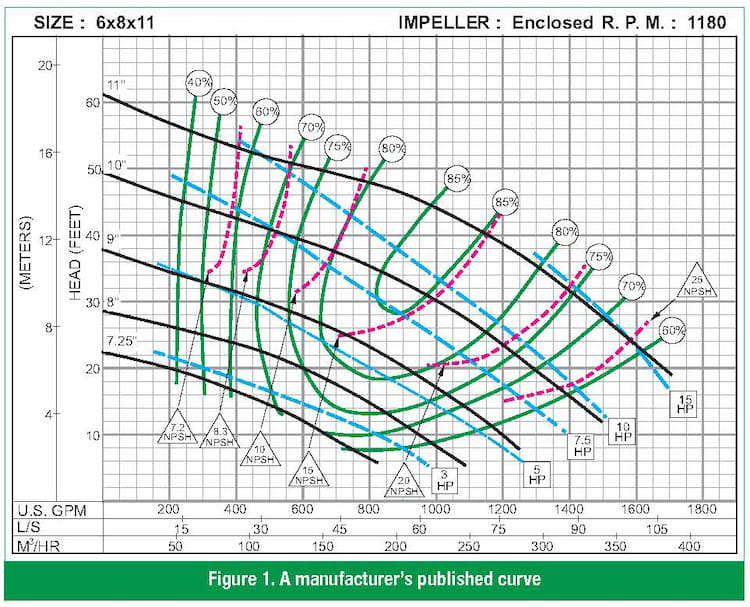

To better understand the performance of the digitized curves, consider an example of a typical published pump curve from a manufacturer. Figure 1 shows a detailed curve that includes the flow versus head performance curves as well as isometric curves for efficiency, power and net positive suction head required (NPSH). These curves accurately represent the test performance of the indicated pump in accordance with the ANSI/HI 1.6-2000 Centrifugal Pump Tests standard.
Figure 1. A manufacturer's published curve
If a pump were required for a system with design conditions of 800 U.S. gallons per minute and 35 feet of head and this particular pump were being evaluated, the system designer could feel confident that this pump, with a 10-inch impeller, would successfully fit the bill. The pump selection and evaluation software must accurately reproduce the manufacturer's published pump curve to aid the customer's evaluation of the pump for the application. The key to generating accurate digital curves is the method with which the pump performance data is saved and displayed.

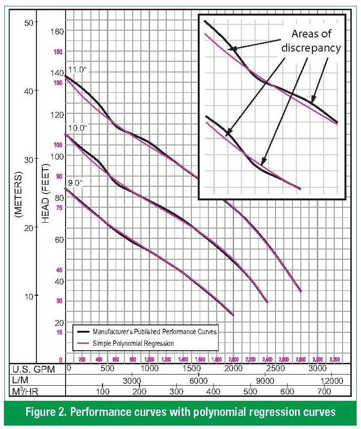

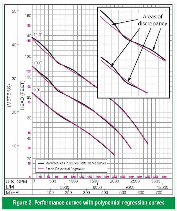

Polynomial Regression
A closer look at some actual pump curve data illustrates the problems associated with the simple polynomial regression method of curve digitization. Figure 2 depicts flow versus head performance curves, which are the primary search parameters for sizing a pump. The black curves are the actual tested performance curves provided by a pump manufacturer. Overlaid in pink are the performance curves generated by a pump selection tool using a simple polynomial regression. The inset is a close-up view of the anomalies in this case study.
Notice that pump performance curves with anomalies, such as inflection points, are not well represented by the polynomial regression. The polynomial regression has a tendency to smooth out the anomalies such as those shown in Figure 2. The consequences of this curve characterization can be minor, or they can be significant. In this case, if an end user were sizing for a design point of 300 U.S. gallons per minute, at a total head of 126 feet, then this pump might not even be considered for evaluation.
Figure 2. Performance curves with polynomial regression curves
A more detrimental scenario could occur if the polynomial regression curve rose significantly above the actual curve. In this case, the program may suggest a viable pump that might not meet the design point criteria. In addition, if the pump performs in areas where the polynomial regression curve deviates from the manufacturer's published performance curve, an end user will get erroneous energy usage figures and operating costs.

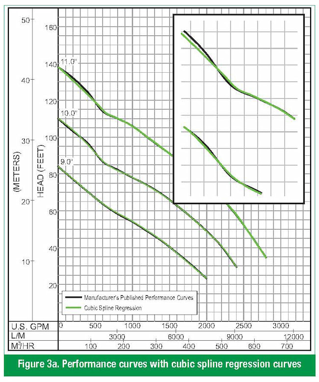

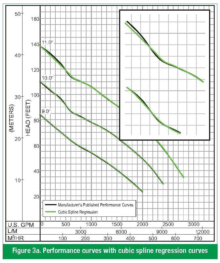

Cubic Spline Regression
Figure 3 depicts the same manufacturer's performance curves in black. The green, overlaid curves are generated by a pump selection tool that uses a cubic spline regression analysis. This method forces the curves to pass through every collected data point. It then smooths the curves from point to point to provide clean, accurate pump performance curve displays. Flow and head are never significantly overstated or understated at any point in the curve range. End users can use these displays with confidence when performing pump evaluations.
Figure 3a. Performance curves with cubic spline regression curves
Even the best numerical analysis techniques cannot predict anomalies between data points. If the performance curve to be digitized has these types of dips or abnormalities, it is imperative that enough data points are collected in and around that range. At a minimum, data points should be collected at the edges and at the peak (or valley) of the anomaly. Ideally, a couple more points should be collected between them. This allows the selection tool to display the most accurate representation of the original performance data and for the evaluation and selection process to proceed without any false selections.
